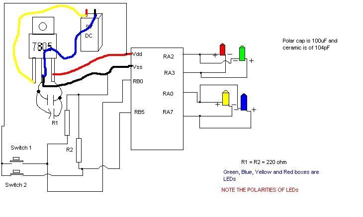

Edit: Kindly see the circuit that is exactly how I connect it, nothing more nothing less
You don't have any capacitors on your power supply.
Also, it's not a good idea to drive LEDs straight from a pic without resistors.

To run properly without a programmer attached, MCLR must be pulled high with a pullup resistor. Use any value from 10K to 33K (I always use 33K). Pulling it low just puts the chip in reset - nothing happens till it goes high again.
You should have a 0.1uF ceramic capacitor close to the chip from VDD to VSS, and a 10uF electrolytic (or bigger) is a good idea somewhere near the chip from VDD to VSS (observe polarity).
As House0Fwax says, put (typically) 330 ohm current limiting resistors in series with each LED. 180 ohm to 470 ohm is the typical range for current limiting resistors on LEDs. Depends on your LEDs and how bright you want them.

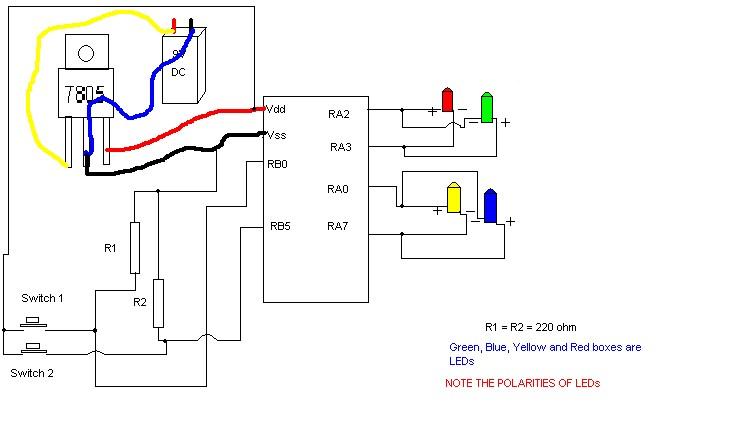

I understand that I need to couple the AC and so I tried this (see the ckt), but that is not working infact LEDs are now start blinking (red and yellow ). I don't get what do you mean by "...somewhare near the chip....", I mean whether it is near the chip or even at long distance , should not make any difference as far as the caps are across the Vdd and Vss.

You definitely need a resistor from MCLR to 5V for the pic to run, if this is missing the pic may run intermittently and produce flashing LEDs. This is normally taken care of by the Pickit2 but once you remove it, you have to supply the resistor.
Also, if your 9V supply is a wall wart then you may need an electrolytic on the 9V side. You should also have a 0.1uF capacitor on both sides of the regulator and a small electrolytic on the 5V side. The 104pF capacitor is probably a 0.1uF anyway - 0.1uF capacitors are marked 104, that is 10 + 4*zeros after = 100,000pF = 0.1uF. It is important that the 0.1uF cap is near to the pic pins, this is to suppress fast switching currents. I'm sure you have checked it anyway but have you checked the obvious things like the voltage on the actual pic chip, many problems here have been solved with a new battery.

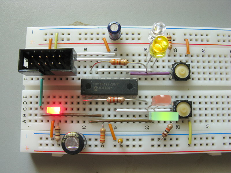

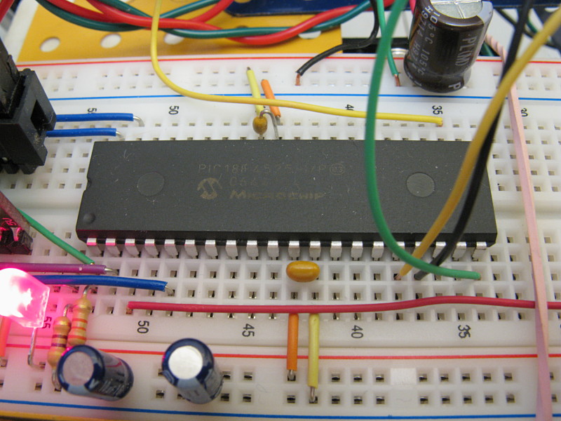

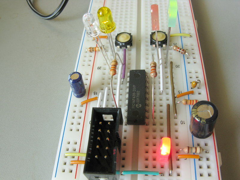

Physically and electrically (same thing) as close to the chip as possible. See the tiny light brown/orangish 0.1uF caps across VDD/VSS on both sides of this chip. This breadboard is controlling a motor controller and there are motors about 1/2" away too, and the whole thing runs off the same battery pack (breadboard has its own regulator) so there are a few extra electrolytics to smooth out any buzz and/or dips in the power.
At the bottom left you can see the 33K MCLR pullup resistor right beside the power LED's current limiting resistor.

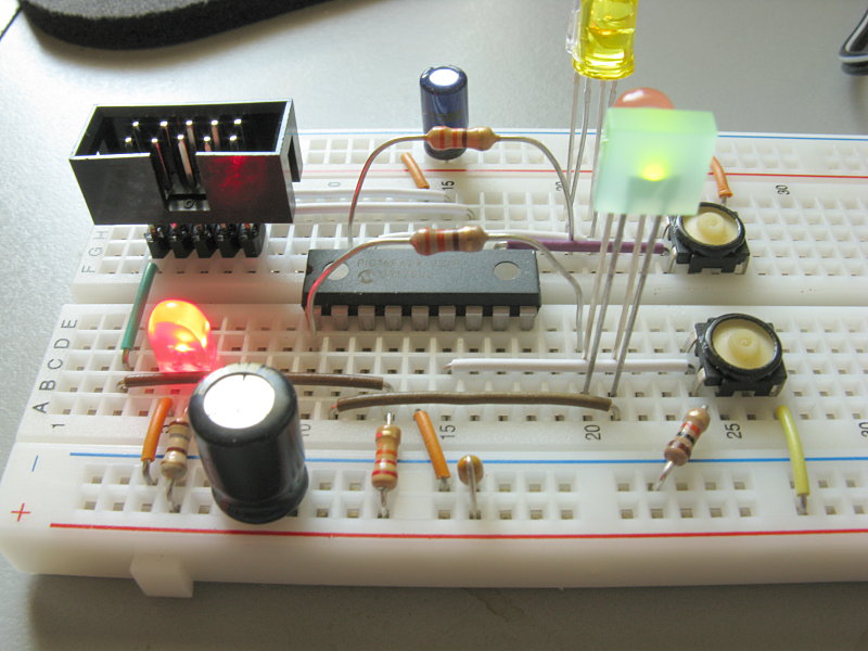

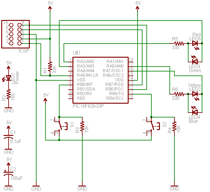

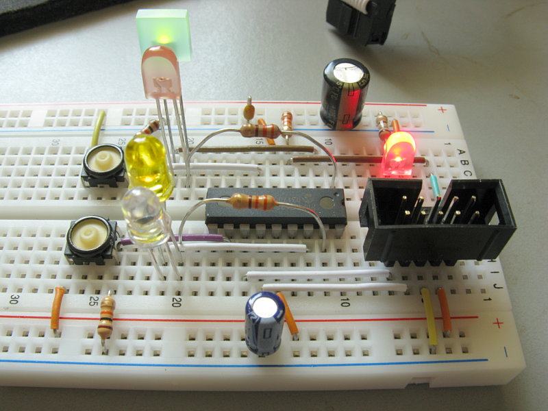

Here's a YouTube movie of it in action:
And here are some pics of the circuit for you to compare with yours. Those are 330:eek:hm: current limiting resistors on the LEDs. The MCLR pullup is 22K:eek:hm:. The power LED has a 180:eek:hm: resistor. The switch pulldowns are 10K:eek:hm::
My power supply is a wall wart plugged into **broken link removed**, so the capacitors on the breadboard are really redundant and unnecessary for me. I put them there for your benefit. There are a 100uF and 10uF electrolytic and a 0.1uF ceramic on there.

Thank you ! futz turning off the WPUs work !:), why they were causing the problem ?
You can't have pullup and pulldown on the same switch. I'm not positive that was the whole problem anyway. A switch that is pulled down to ground with a resistor is expected to go high when pressed. If it is pulled up to VDD it is expected to go low when pressed. Your code expected the switches to have pulldowns and go high when pressed. Adding pullups into that is just confusing. You probably ended up with a halfway voltage that might or might not trigger the interrupt, sometimes. :p It was probably effectively floating. A floating pin can do random things.
