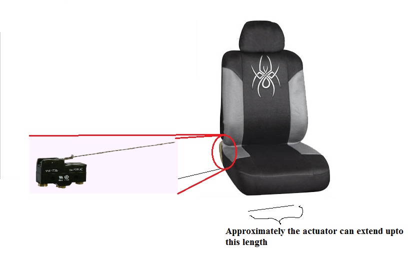

Sir i have made a simple sketch. Can it be done like this ?
I know of microswitches used for that.
You also must not detect the weight of a package or other object so you should find the minimum weight of a vehicle occupant to some level of confidence. How bad or good are each of the last two outcomes below?
Person correctly detected, OK
No person correctly detected, OK
Person incorrectly detected
No person incorrectly detected
Packages don't move but people do so you might want to look into a vibration/accel sensor.

Thank you sir. I'll go through it.
You place one of these at each of the four corners of your load plate. This will give you 200kg max load and an 300kg break point. Output can be run through a simple op-amp buffer to both buffer the signal and scale it to full range for the ADC you are using. A quad-op amp package would give you a single chip (plus a few resistors) solution. Add a micro with four channels of ADC. Convert the buffered voltage from each of the four sensors and then sum the results to get a weight. You will need a 10-bit ADC to get useful resolution. At 10 bits, you are looking at ~0.2kg/0.4lb minimum resolution at 200kg full scale.
If you want temperature compensation, at a fifth cell that is passive and use its value to offset the other four appropriately.
