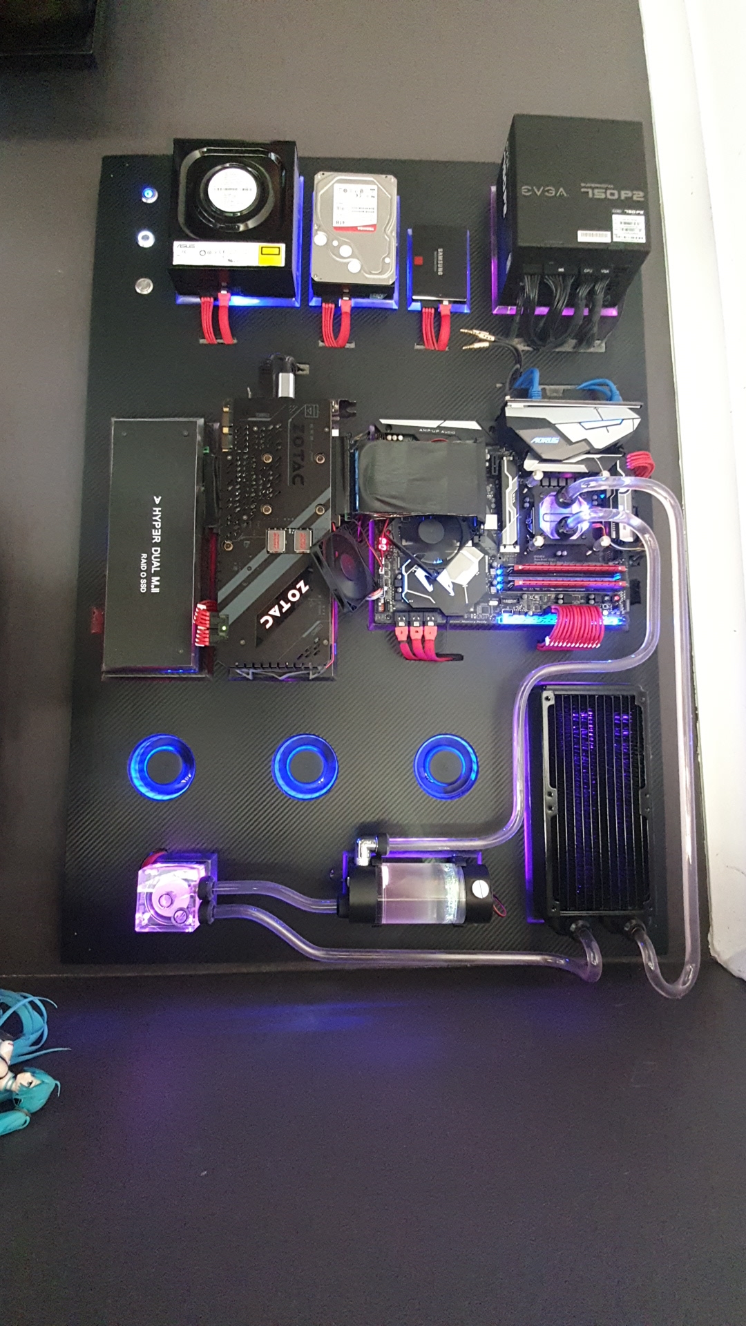

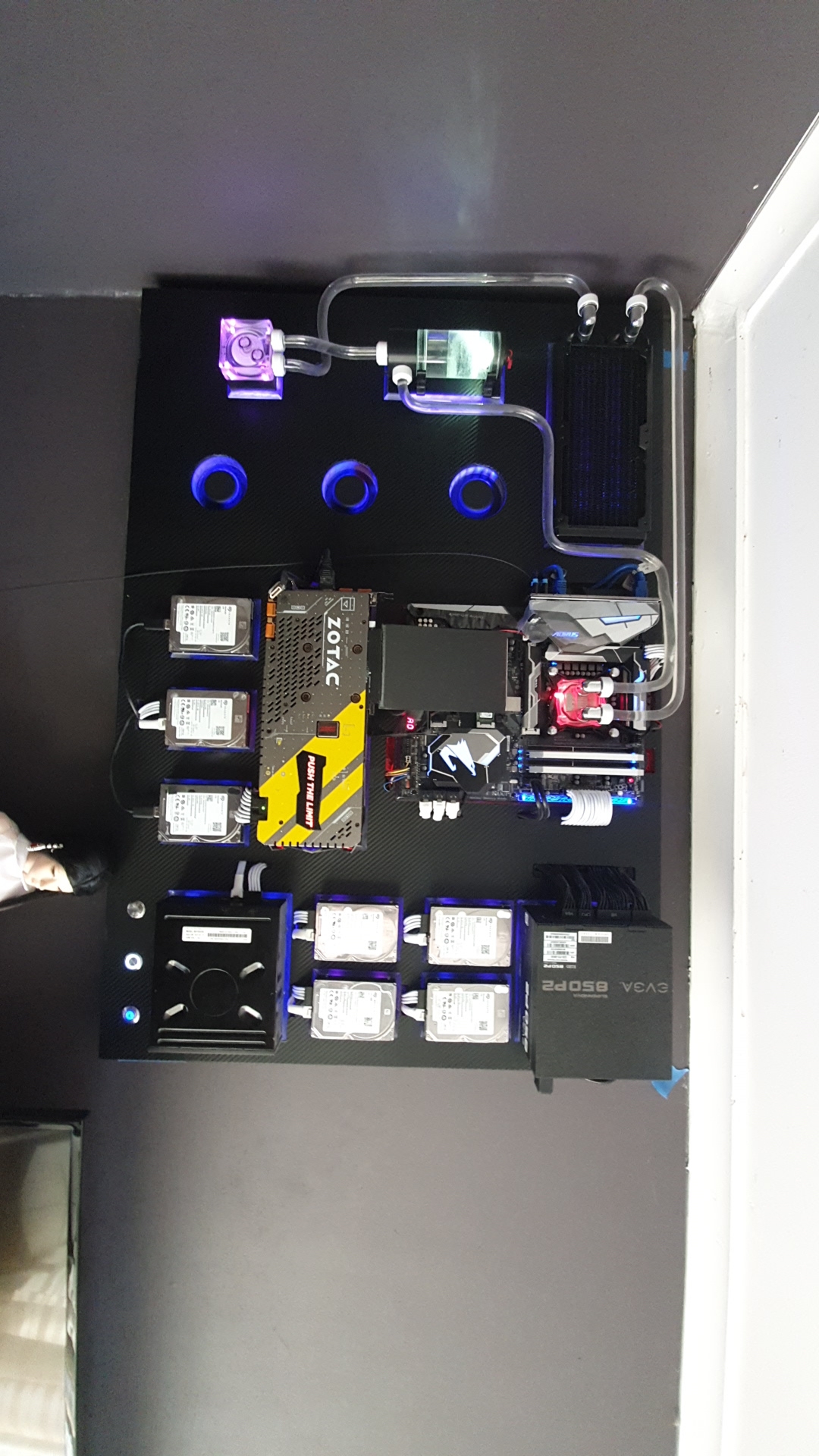

Hi
The DC converter is one of these
The input is via a computer power supply.
So the DC DC converter powers the 3x 120mm blowers
