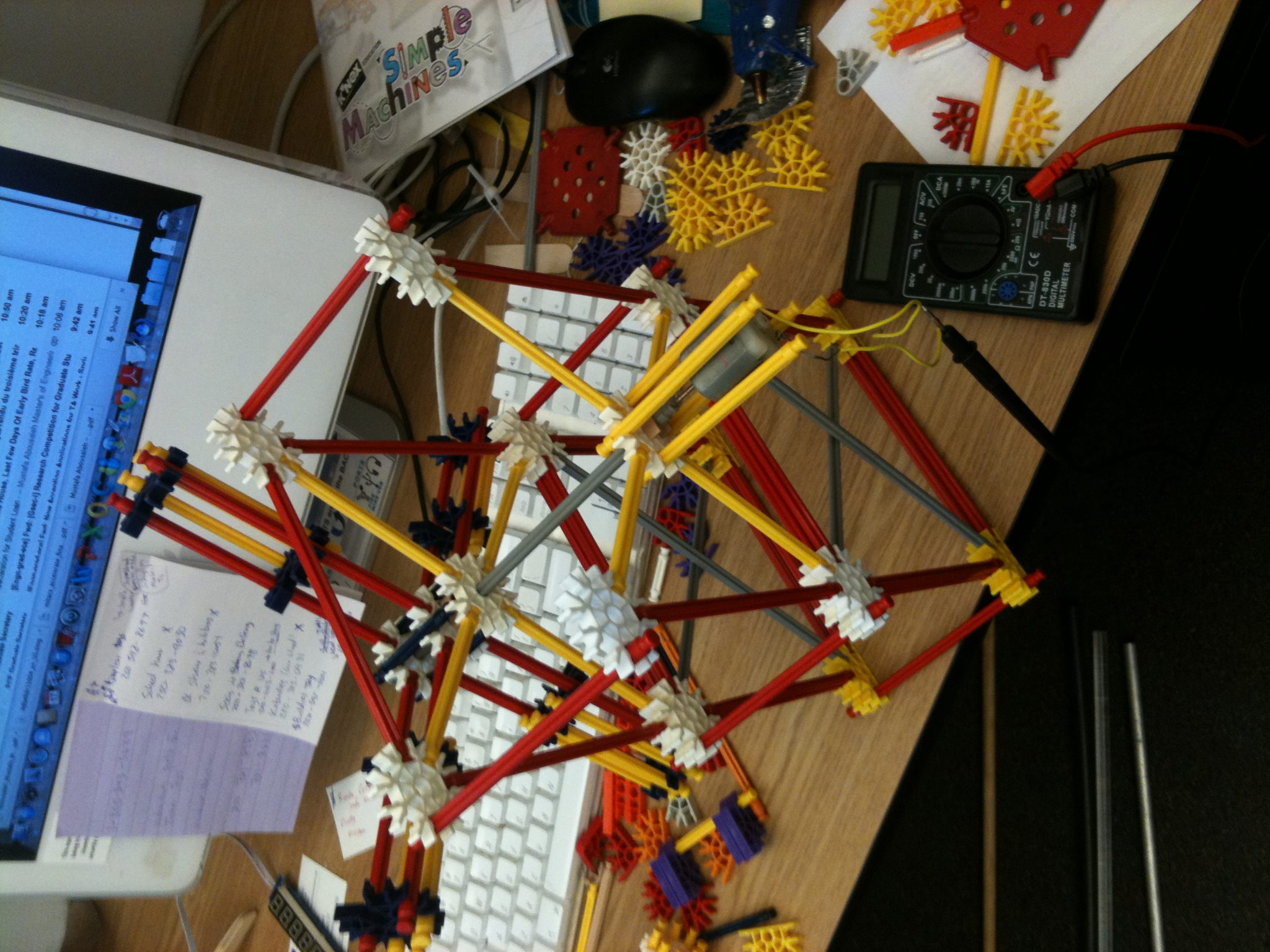

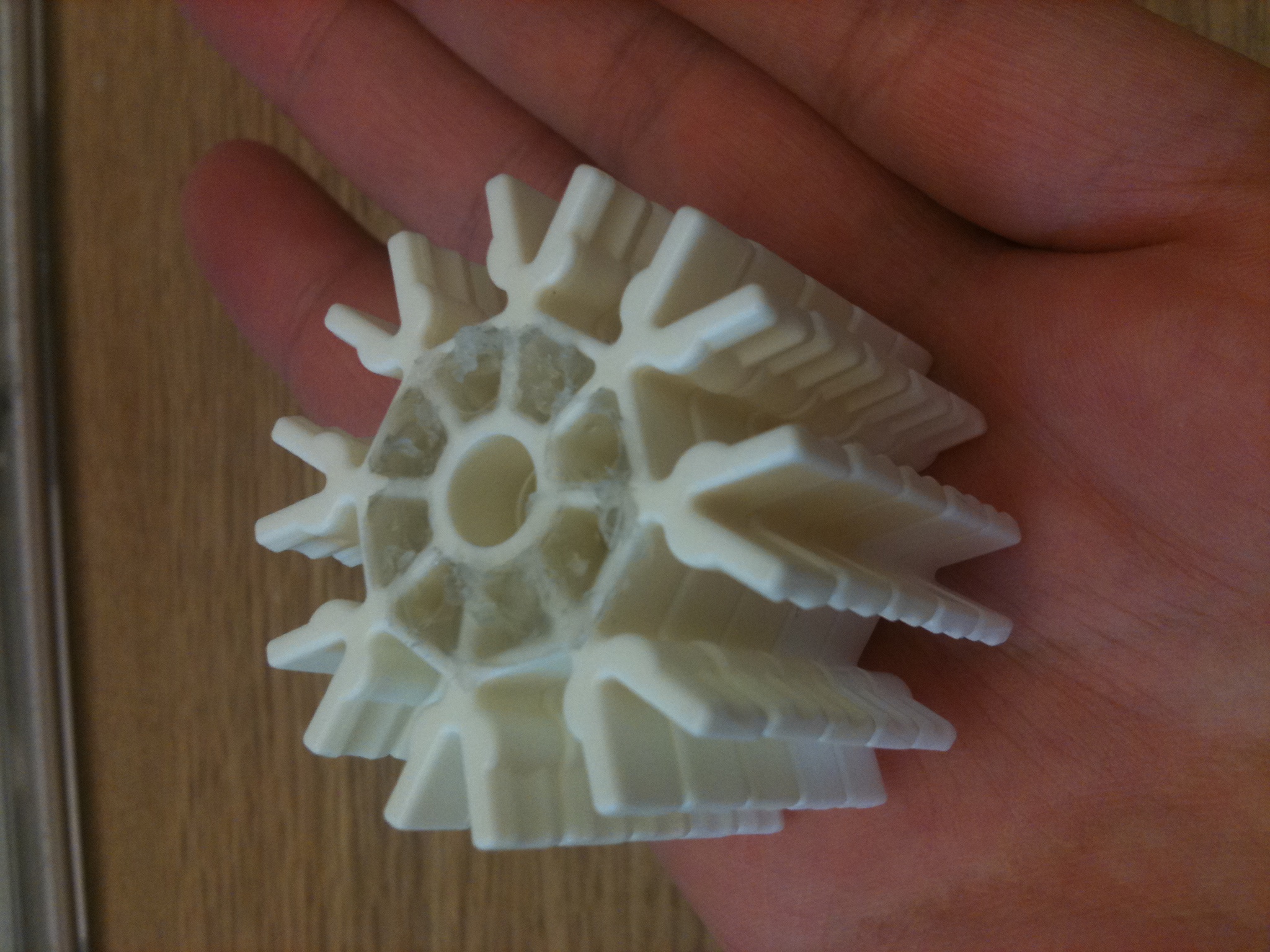

I have been experimenting with different materials to allow kids to build the rotor (wheel). What we need to do is give them a core and allow them to build around it. After a while of thinking and testing, I managed to put together a core using K'nex toys by glowing together a few similar parts (see attached photo Core.jpg).
The idea is to then allow children to build around that core. Their design will act as the wheel. They will also use different materials such as plastic cups, clear tape, etc... to fill spaces in between. This then will attach to a generic base which is attached to a motor to generate power.
For quick prototyping, I used K'nex to make a base (see attached photo Turbine.jpg).

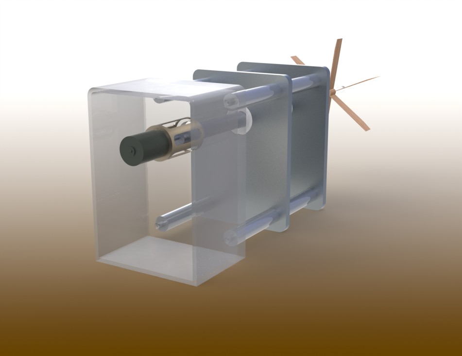

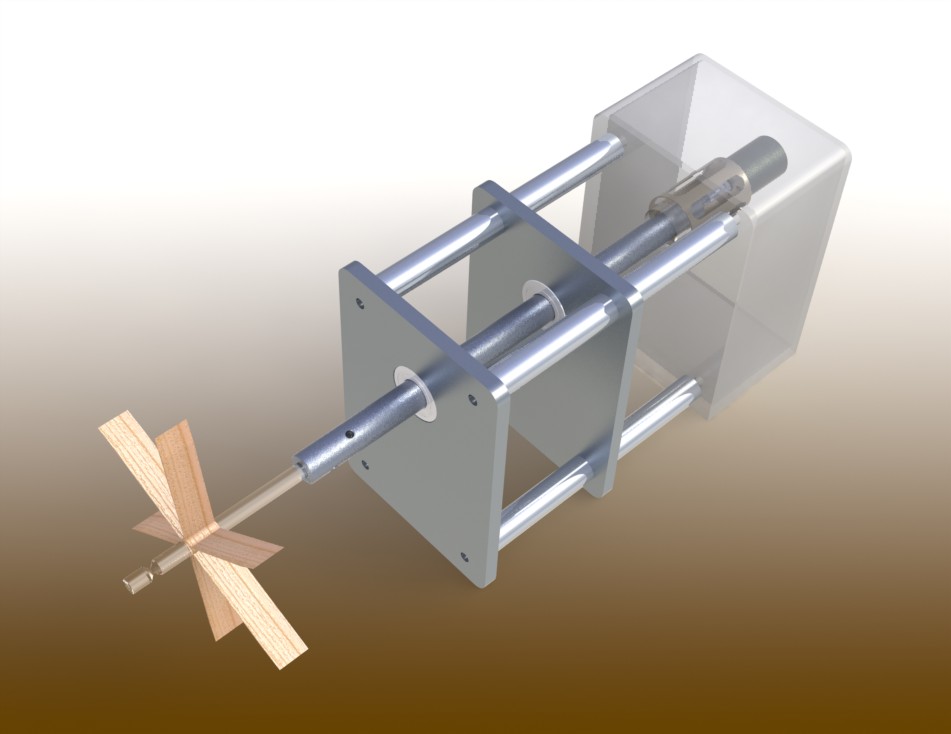

The final design will be sturdier. I put together a mock up of the final turbine design in SolidWorks (see photos Top View and Back View.jpg).
