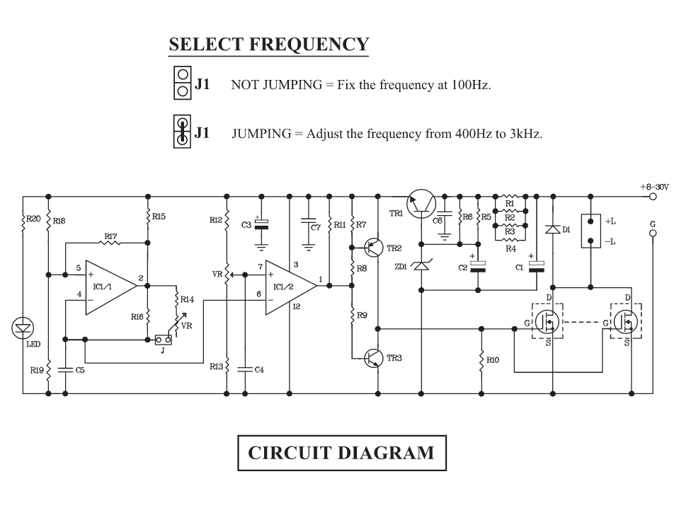

I would like to build a power supply for experimenting with water electrolysis. The information I have calls for a square wave pulse, timed 0.001ms "on" and 0.003ms "off" (250KHz). It is supposed to supply +26V at 50 amps into the cell.
I am considering the power stage of the attached circuit. But rather than build a signal generator from scratch, I intend to connect a function generator at the junction of IC1/2 pin 1 and R11.
Am I on the right track or can someone suggest a better solution?
If the 250KHz is problematic, it may be possible to reduce it to as far as 25KHz.

I am a little confused as usual. The text says hz or khz who knows and the picture from #1 clearly says hz.
The poor way the MOSFET's gate driver is built it must be hz. (slow not fast)

My apologies for error in my OP. The diagram I attached specified it is capable of up to 3KHz, and I mentioned 25KHz would be acceptable if 250KHz is not. It is a PWM speed controller. I was considering to use or adapt the power stage after IC1/2.
If there is a problem with the gate driver, where can I find a better cuircuit? Note that this is intended to power an eletrolytic cell, not transmit RF.

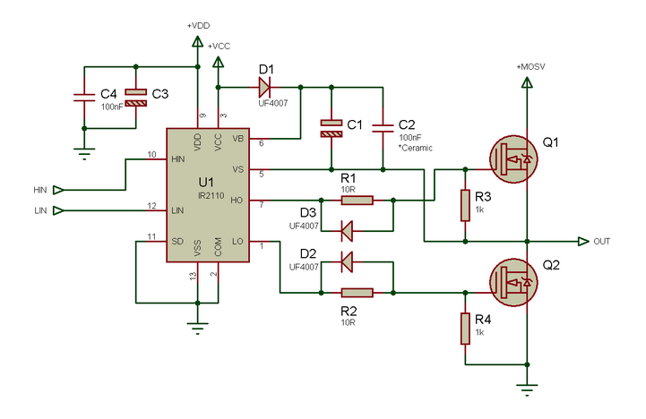

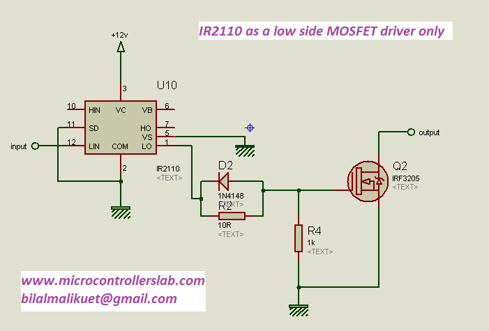

If you have a function generator that you can set for the frequency and duty cycle that you want, then just use it to drive a mosfet gate driver.
Here is one that is still available in a DIP package. **broken link removed**
The output of the mosfet driver drives the mosfets, but I recommend a resistor (10 to 100 ohms) in series with the gate of each mosfet.
Stay with this thread. No reason to start a new one.
The IR2110 is a highside and a lowside drver, instead of only a lowside driver like the one I proposed, and like your original circuit.
See that extra Q1 mosfet? It pulls the output up to the positive supply rail. Do you need that?
Thank you for your suggestion. Yes, I probably don't need the high side feature, unless it has better load driving properties I have yet to learn about. All I want is current flow from the cell's positive electrode to the negative.
Do you see any need to improve upon the circuit below? The original circuit I posted used two N-channel MOSFETs in parallel and seemed to have extra protection. I need to supply about 50A at 26V to the cell, which is not a typical load, and ensure the driver will not be adversely affected.
