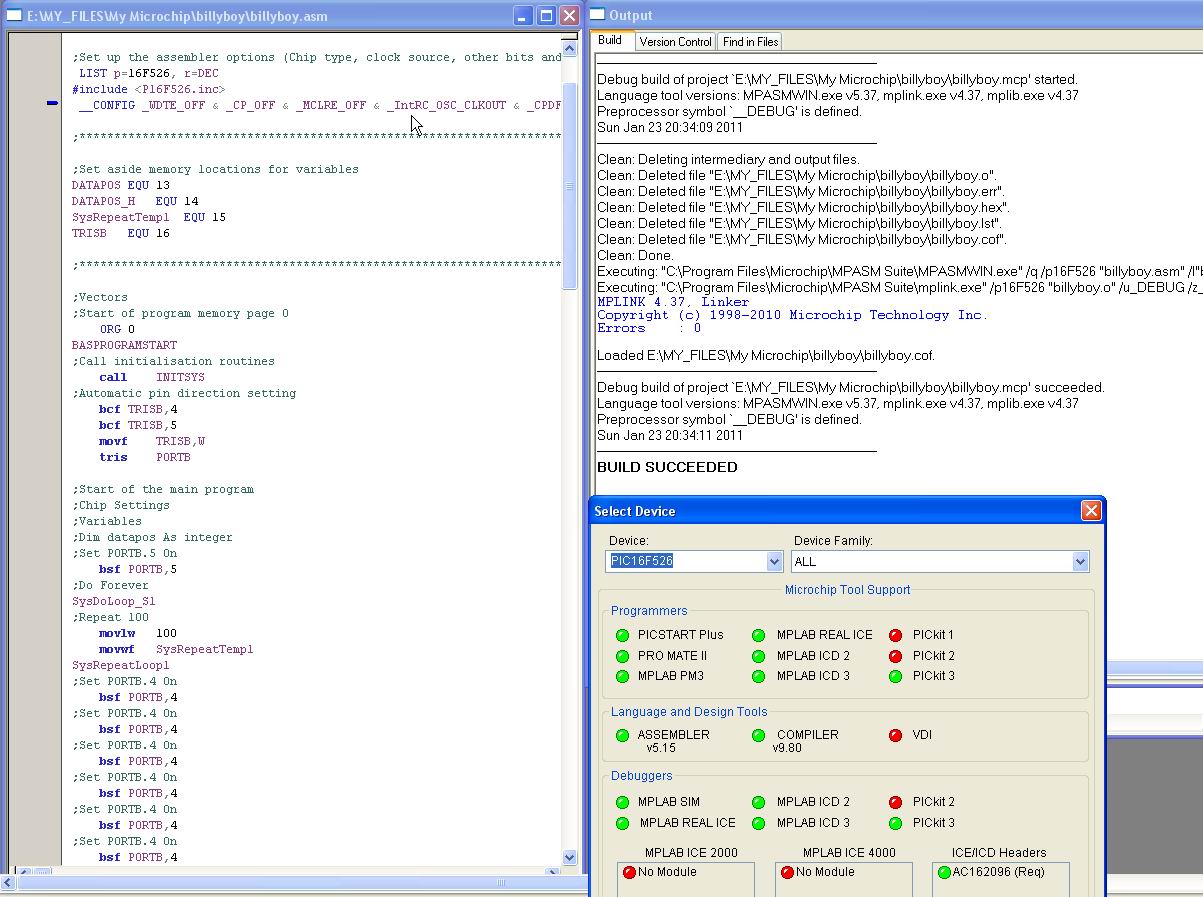

Apart from just changing two characters to lower case on the Config line - see pointer, you code builds ok.
Have you Configure , Selected that chip for your Mplab project ?
Or are you trying to program the 526 code into the 886 chip ? - you cannot do that without modifying the assembler code for the 886 chip.

Could you tell why you need all of this? You can only turn it on or off a simple delay would be better
This would
SysRepeatLoop1
    bsf	PORTB,4  ;Set PORTB.4 On
    movlw D'23'
    movwf temp
    DECFSZ temp
    bcf  PORTB,4  ;Set PORTB.4 OFF
    movlw D'23'
    movwf temp
    DECFSZ temp
    Return
SysRepeatLoopEnd1
get rid of all this basically

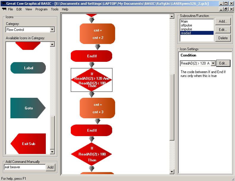

my compiler looks like this: i wasnt sure if you guys would use this, or be compatible!
and here is what code is:
