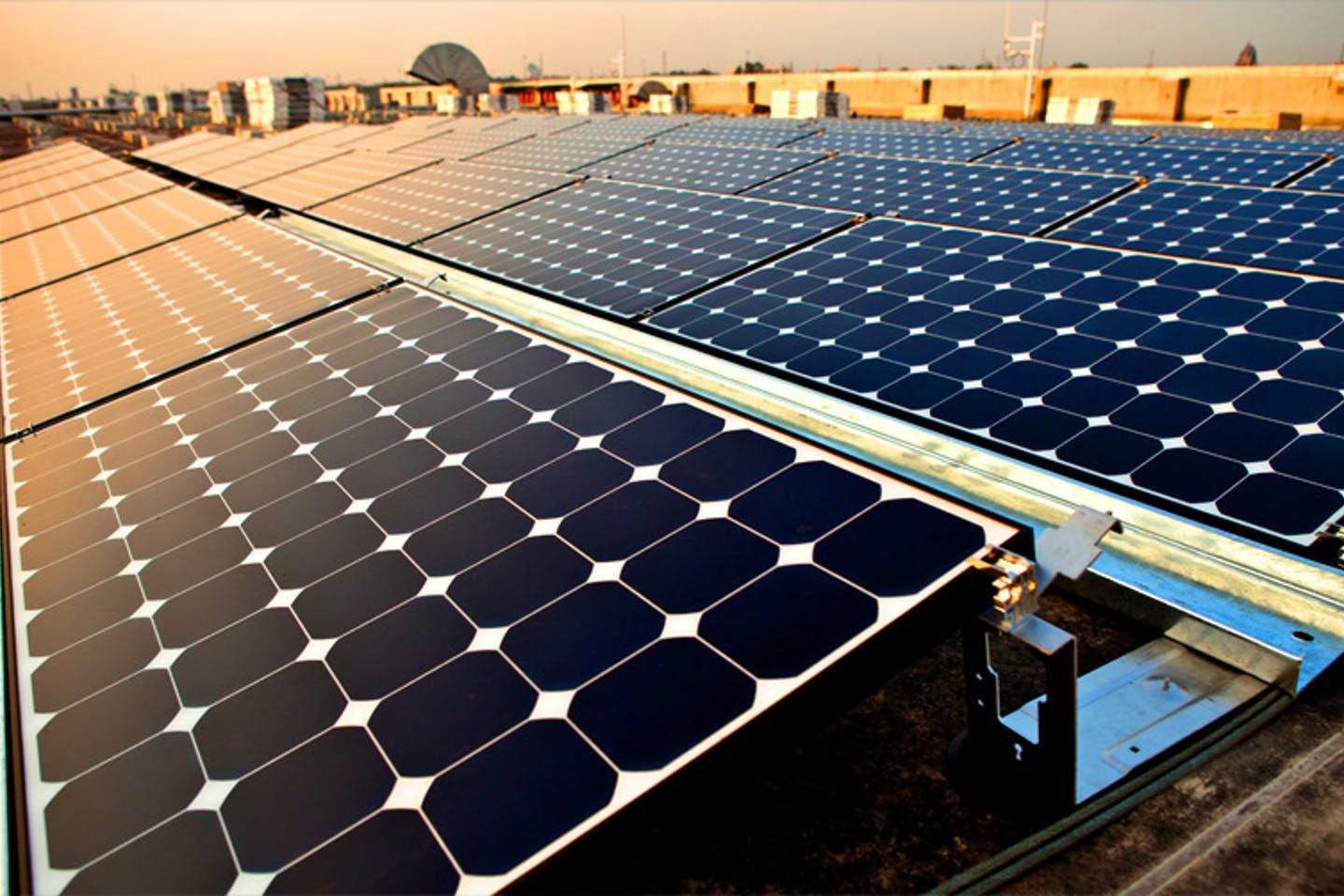

You have to select a solar panel with appropriate wattage. Here is a guideline about how you can select the right one.
