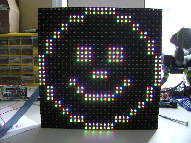

I tried to incorporate your code idea into my original SXB program which is attached as a TEXT file so you can view it with Notepad or something. I have commented out unused or modified original SXB program code.
This program does nothing but display a smiley face in red, red2, green and blue LEDs. See attached picture. See how they are offshifted for the different LED colors.
I tried adding a PAUSEUS 0.020 between the CLOCK and ST statements and varried the amounts dramatically and saw no differences. I also adjusted the differences of the PAUSEUS after the OE = 0 and this sort of did something with brightness (low number like PAUSEUS 1 was dim and higher number like PAUSEUS 100 or more was brighter). However when trying to add a nested loop caused such an increase in delay that no changes in the brightness PAUSEUS statement made any difference (just stayed bright).
Anyway - perhaps you can modify the working SXB program to see how I am acheiving the SPI routine.
Let me know...Thanks!

How can this be information be applied to the /OE to get the 256 shades per LED?
It can't. As I mentioned earlier, applying a PWM signal to the /OE inputs will allow you to adjust the overall display brightness.
Also, as you're looking at solutions for full RGB color control, consider this; You're basically talking about sending 512 bits of data (64 bytes) to the display latches 256 times during a 16.67 msec period. That's 16,384 bytes for a 24 bit color 'still' frame, assuming redundant red LEDs. If you can send 64 bytes to the latches every 65.1 usecs (1/256th of the frame rate) and you can buffer a 16KB 'still' frame in Flash you're in good shape. Otherwise, you're looking at compressing the 'still' image, perhaps using 2048 bytes of 0..255 LED PWM values, and building each 64 byte update stream from that but I doubt you're going to be able to do that within 65.1 usecs.
I can't help wondering if 8 bits per color (256 colors) might be a better target?
Good luck. Mike

I don't know if it really is pushing the envelope. For just sending out SPI based data, it is a piece of cake. The problem has come in when trying to get shades of Red, Green and Blue LEDs on these SPI based modules - or what I beleive is refered to as PWM.
We know that it is possible to get all of this done.
Normally these modules are daisy chained together in the dozens or more. The output jacks connect to the input jacks on the incomming modules next in line. However, the first input jack normally goes to a "receiving board". I don't have this board but trying to have my client ship one to me to look at. This may be the missing link in how this is done. This board then sends out the R1A, R2A, R1B, R2B, G1, G2, B1, B2, CLOCK, LATCH, /OE and GND signals to the first input jack. Some kind of controller is on this "receiving board" to do this PWM. It also has Ethernet and would then normally goes to a "Full Color" controller card that plugs into a PCI slot on a PC. It has Ethernet input jacks, DVI connectors to plug into the PC's DVI connector and so on.
I am trying to (I guess) tap into the these modules and somewhat replace the "receiving board" and maybe the "Full Color" controller card.
Since simple SPI data is being pushed through the cascaded modules, it is very possible to do this with a micro-controller. However, it may need something more robust than a Parallax SX28 or SX48 chip for PWM, RAM, Eithernet(?), other features, etc..
This is where my delema is. I hope I have explained it better now.
hi, do you mind if I ask how much these modules are - and where from, as itd be so much easier if i had one to play with - and who knows id quite like a video wall :D
have you looked at microElectronica BASIC, it is a basic compiler for the pic, would let you stick to a language your used too. but for the time critical bits you probably need some inline assembler. i assume your sx is something like a basic stamp, where the code is interpreted on the chip. mE compiles to native pic code. you can download a demo from their site, limited to 2k program on the demo - which is quite big.
There is NO pwm on these modules, the only way to set the brightness of each individual led (colours) is to turn them on and off in quick succession through your spi.
your spi can run at up to 25MHz, so thats more than enough, so its basically down to the software.
