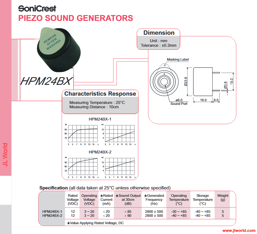

I dont understand what's going on here, but it seems to be doing it with several different types, except for a small PCB mount one I've got.
Specs say supply voltage is 3-12V.
I have my lab power supply set to 5V.
But the voltage rises on the meter when I connect the buzzer!
My multimeter reads about 7V when connected but drops back to 5V once I disconnect the buzzer.
Any ideas?

This is an easy EMI stability test for any power supply by creating a short current spike that affects the FB voltage compensation filter to raise the voltage. Congrats. ;>}
The HPM24BX-1 piezo buzzer only draws an average of 2.5mA @ 5V but the impulse current may be >>10x higher for << 1/10x 100% of the duration of its 2800 Hz or 357 / 2 us resonance interval. That's equivalent to only a 2Kohm load so adding 100 Ohms in series would hardly attenuate it. Adding that series R might change the sound quality which could be fixed with a ceramic cap. if need be. But I doubt it.
Shunting the whole power supply output may require a much bigger capacitor with a very low ESR because of the low driver resistance.
Now you can measure the current on a scope and see why your supply responded so badly to a disturbance from poor compensation, layout or noise sensitivity.

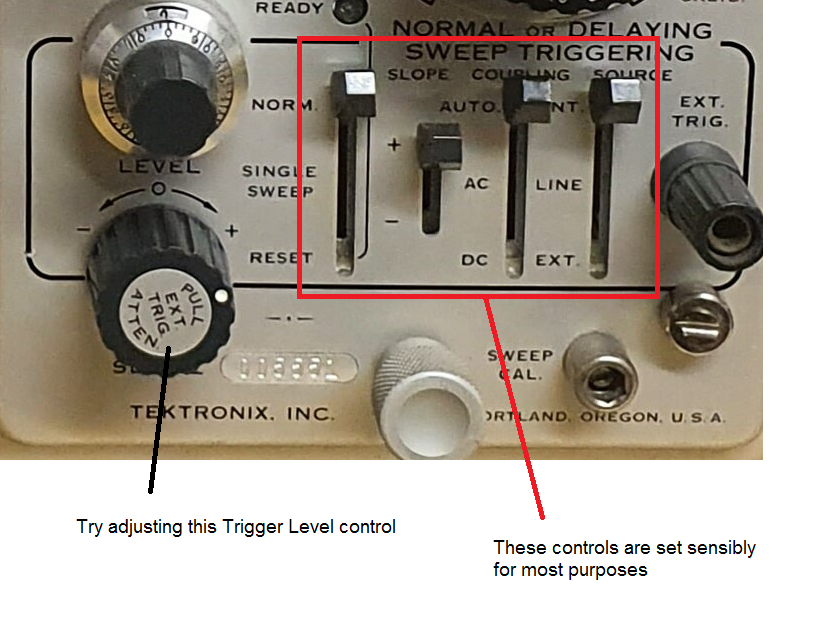

That is not the correct way to use that control.
The "normal" way to use it, is to have it turned fully clockwise until the UNCAL lamp is extinguished.
Then the timebase is calibrated as per the numbers on the big switch, ie 0.5mS per division in your last picture.
The correct way to make the waveform display stand still, is by use of the timebase trigger controls.
In the last picture, the triggering switches are set to sensible positions, but the "trigger level" control is probably not well set.
See the picture below:
Try turning the trigger level control anti clockwise so that it is somewhere in the middle of its rotation.
Something which complicates the issue is that this scope has a dual timebase for delayed sweep operation. This can cause a lot of confusion for a beginner.
Otherwise, that is a nice old scope that you have there.

I will take a look at that trigger control. From memory it didn't do much when adjusting it.
The knob also pulls out for "external" trigger.
Not sure how that works yet.
