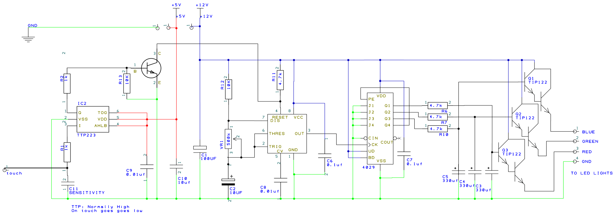

Power source is a wall wart 12V 1A
My circuit requires the full 12V but the touch sensor in this circuit (TTP223) needs just 5v.
The datasheet on the TTP says the following
~Operating voltage 2.0V~5.5V
~Operating current @VDD=3V, no load
~At low power mode typical 1.5uA, maximum 3.0uA
id like to use a voltage regulator like LF33 but one that outputs 5volts not 3.3volts. I understand the datasheet says it will work at 3.3 volts but i have read that the TTP works better at 5volts. Can you help me find a suitable component that will supply the TTP223 the voltage and current it requires? I would also need some help with the capacitors needed at the input and output.
Im sorry i dont know much but i am trying. I do know that these IC's get hot. I am hoping that if the IC has a fixed output, the right caps are used, and that its drawing very little current it will be safe enough to use.
Im attaching my schematic. so you can see where everything is.
A 78L05 should be enough

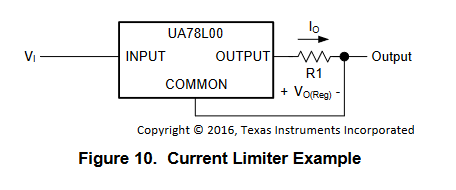

I see this 78l05 works as a current limiter as well. See sample.
Screenshot 2022-05-15 at 20-33-20 UA78L00 Series Positive-Voltage Linear Regulators datasheet ...png
Does this example fix the current based on the resistor used. and will it maintain that same current regardless of the voltage applied to the input? Id like to use it to power an LED on my Buck converter project.
Sorry, I read your initial post as max current for the TTP as 30mA.
At 100mA it'll probably overheat.
However, I don't think that chip will take anything near 100mA and probably only a few milliamps.
Couldn't find it in the datasheet.
If you use it as a constant current source then the input voltage needs to be 5+Vf of LED + Vdropout(appears to be 2V) so in excess of 9V.
The resistor should drop 5V (assuming 78L05) at the required current.
Note, heating could be a problem if the input voltage is too high.
It is also very inefficient so not for battery operation.

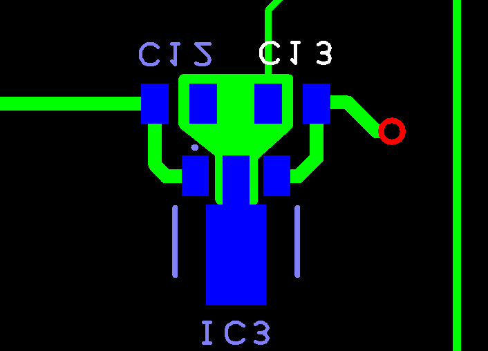

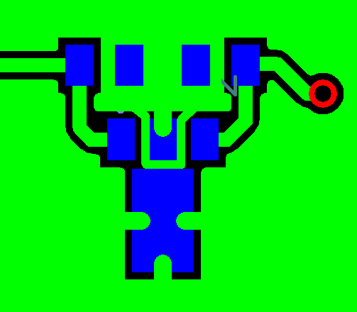

I added the IC to my circuit. and created a pour to connect the ground pads together.

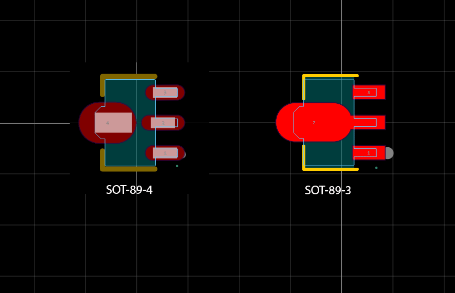

Observation:
the PCB has 4 pads. 3 have pin assignments but the large pad has no assignment. Is that a heat sink?
In EasyEDA there are two SMD devices a SOT-89-4 and a SOT-89-3.
Here are the footprints,
I suggest you find a datasheet for the actual device you are using and see if the 4th pin is connected - in the above the two horizontally aligned center pins are both connected to ground.
I think they are internally connected so the device is actually a 3 pin device.
In the diagram above the either footprint could be used for either device!!
I agree. Thought of that this morning. It is indeed a 3 pin device. In reality if i applied solder to the pin pad it would flow to the isolated pad. I was concerned as it was not attached to a net in the PCB so i attached it to ground and the pour applied the needed spokes.
