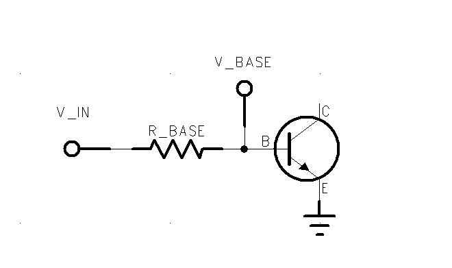

OK thank you all, I'd like to try and get it working with optimal base current. How do I calculate a resistor value?
Use Ohm's Law, R= V/I. The datasheet for the transistor shows the base voltage but you did not say what drives the base resistor so we don't know its voltage.
If you look at the saturation curves in Ron's data sheet it specs the transistor at a θ of 10. So your base current needs to be 200 ma / 10 = 20 ma. This should give you a Vce of about .1 volt.
You don't say what you are driving it with but lets say it goes to 4.5 volts when you want the transistor to turn on. Also from the curves it shows a Vbe drop of about .8 volts at your current. So you have a drive voltage of 4.5-.8 or3,7 volts. You need 20 ma so the formula would be 3.7/.020 = 185Ω. I think 180 is a standard value.
PS. Start with a new transistor - you probably blew yours when you hooked +5 to the base. :D
Sorry AG. I'm a slow typer.
Thanks all, I will have a play about later when I get home. I am driving the base from an Arduino digital I/O pin so it should be 5V
( Vin - Vbase ) / Rbase
No.
An Arduino output pin has a logic high voltage of 5V ONLY WHEN IT HAS NO LOAD.
Since you are using it to source 20mA to a load then its logic high voltage is about 4V.
