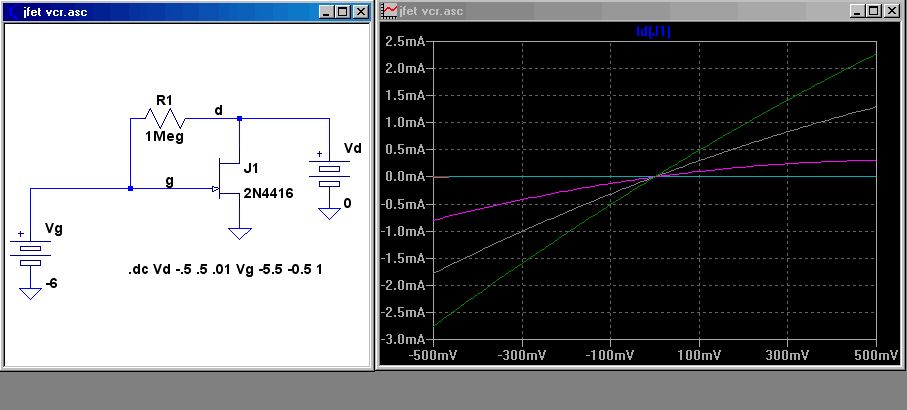

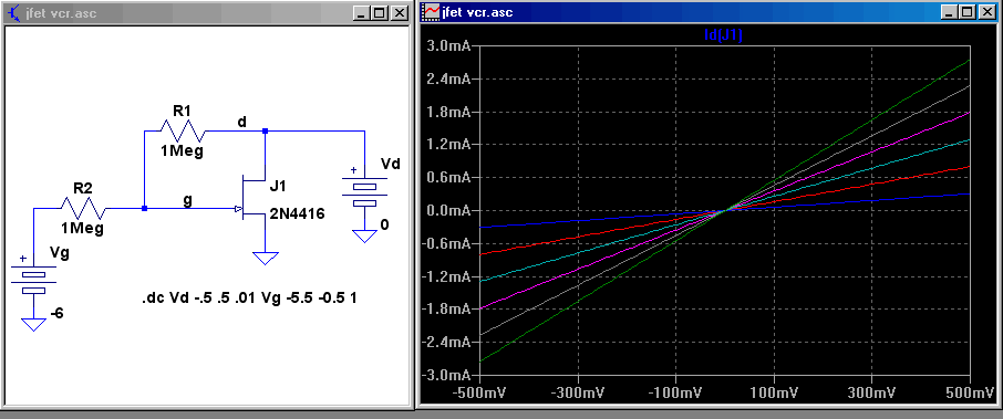

Optikon said:
audioguru said:
FETs cause terrible distortion when used as a variable resistance in an opamp circuit. The severe 2nd harmonic distortion is converted to much less 3rd harmonic distortion if you add half the signal at the drain to the gate. Then you are left with some distortion and a very slow response caused by the coupling capacitor for the half signal fed to the gate.
Can you quantify "terrible" distortion and also can you explain the origin of the 2 harmonic distortion?
Also, what mode of operation are you assuming for the FET (linear "ohmic" region?)
Here are sims of the two methods Audioguru is talking about. Note the differences in linearity of the IV curves. Asymmetry around the voltage and current axes will cause even harmonic distortion. Symmetrical nonlinearity will cause odd harmonic distortion.
Ignore the 1 Meg resistor in the circuit without feedback. I forgot to take it out, but it has no effect and can be ignored. It is needed in the circuit with feedback. Lower values might be required, depending on bandwidth requirements.

Thunderchild said:
those diagrams look impressive so how do i use the fet in my circui then ?
What do you need to do (gain, bandwidth, signal amplitude, available power supplies, etc.)?
audioguru said:
Thanks Ron, that's what I was talking about.
If you keep the signal low, the distortion is reduced. If the signal is really low then it is buried in circuit noise and you don't notice the distortion. :lol:
The one without feedback looks bad..
The second plot (with feedback) doesnt look too bad!
Looks like you swept Vg & Vd. For a given Vg, Id versus Vd looks pretty linear right through zero, just like a resistor should be. In the sense of using it as a resistor, the slope of those lines should remain constant and looks like it does (for a given Vg). So in the feedback case, it is still not clear to me how this causes distortion. Now if Vg is varied along with Vd then that makes for a non-linear resistor of course! But I don't think that's how the intended application works.
The derivative of those plots would really show how well of a resistor the Jfet makes.
Now if the linearity might fall apart with large Vd and/or large Id due to other causes.. I wonder if a network of a bunch of tiny(operating points) but linear resistors makes an equivalent "big" linear resistor.

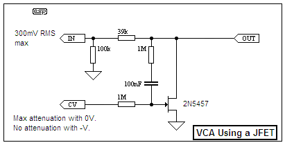

This circuit will work for audio if you keep the signal level low. A negative contol voltage allows it to pass signals and it attenuates more if the control voltage becomes closer to ground. :lol:
