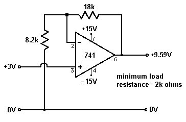

Voltage -/+3 in +/-10 out
Make it like this. Add a 1k resistor in series with the 18k resistor then the output will be +9.95V.
you circuit shows a minimum load of 2 k I am only connecting a volt meter to the output
Your opamp or your meter is not working properly.

Wait... the IDG300 is rated for single supply operation, with Vdd=3 V and a static output of Vdd/2 = 1.5 V. You won't get a negative voltage out of it.
The voltage can swing from 0.05 V to Vdd-0.05 V and the zero-rate voltage is 1.5 V (with Vdd=3 V).
If you're monitoring two axes, choose a dual single-supply op amp, with low offset. Why are you going to amplify the output of the sensor?
Can you recommend an op amp I would like to have 2.5 volt as my static, and + 5volt to zero as my swing. I have an input on my servo amplifier that can accept that voltage.
I just tried it on the sensor with no amp and it does work but with a slower response. I will also need to have a fine tune to stop the motor creaping
The most straight-forward way to do that is to use a level shifter (+1.5 V) with an amplification of 2. Google for "level shifter op amp". Be aware that you may introduce significant error if resistors are not matched.

No, all he needs is a gain of 2.5/1.5. The gain will also do the level shifting.
paul200 said:
Thank you!!
You can use the same circuit you were using before. Make the feedback resistor 10k, and the resistor to GND 15k. You could use a 5V, single-supply, rail-to rail output op amp, or you could use the 741 that you have if you want to use dual supplies.
