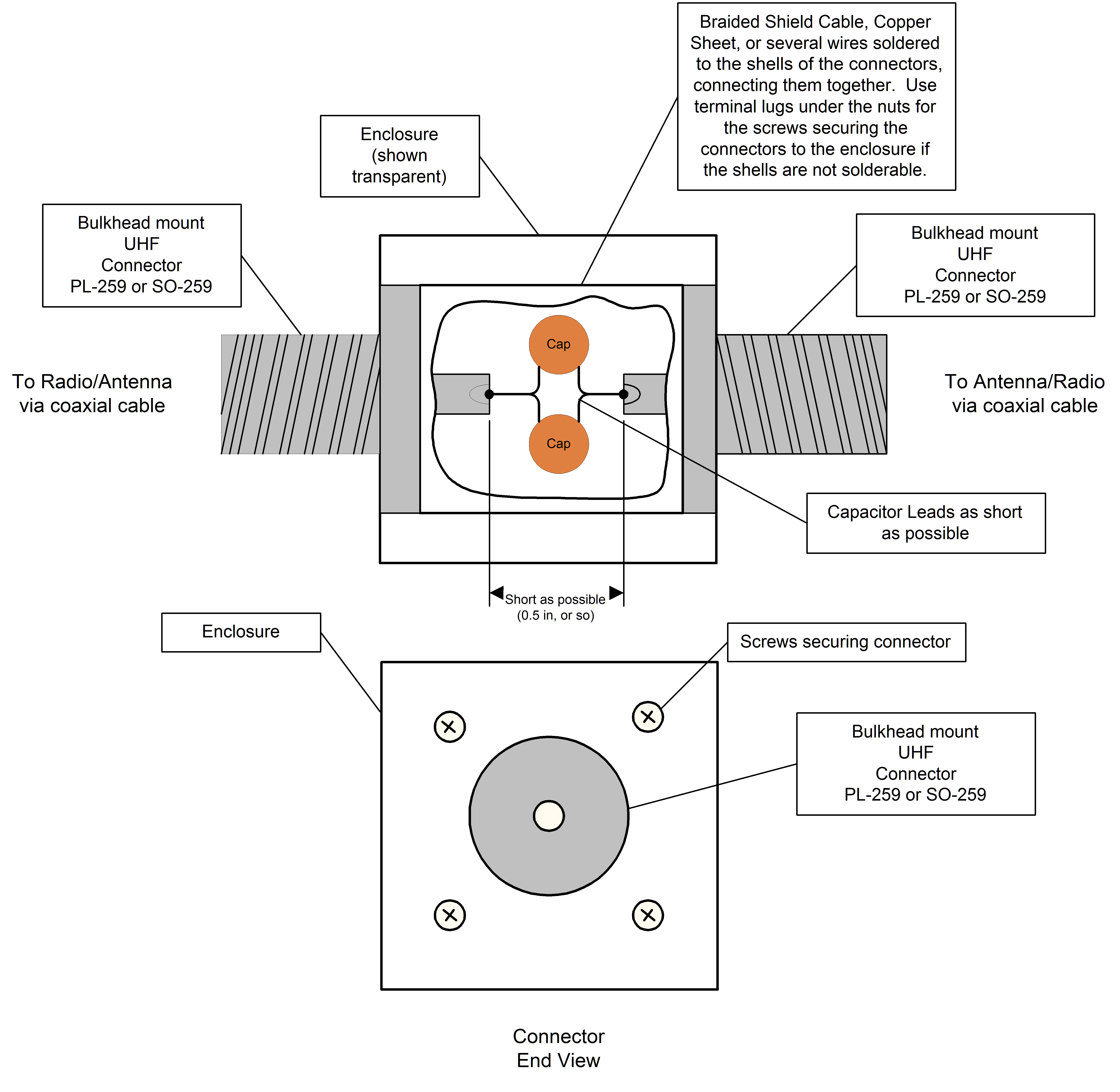

Hi again. The rule of thumb is that a distance of less than 1/16th wavelength is needed to prevent significant impedance discontinuity. So at 200 MHz that is 3.7 inches. I think you should be able to easily build it within less than half of even that distance between the connectors, the less distance between the connectors, the better.
Stripline is a general term for various configurations of etched and layered printed copper traces and various dielectric materials, used to maintain a constant impedance along its entire length. I'm not aware of it being available for purchase in suitable form since it is used with components of almost infinite variety, and therefore is custom etched/fabricated from raw stock material. For that you will need etch resist and acid. If you want to proceed along that line, I don't have that experience, but would point you to this one of many sites on the subject: https://www.electro-tech-online.com/custompdfs/2012/10/RF-Microwave_PCB_Design_and_Layout.pdf
The blocking capacitors are connected between the center pins of the two connectors. I suggested 500 volts because they are readily available from most outlets (such as digi-key mail order electronics), without getting too large in size, and the higher the voltage the merrier. I'm thinking static charge, induced voltage from nearby lightning, and such. I don't know what your transmitter output power is (assuming your radio is a transceiver) but the voltage rating of the capacitors for operation of the transmitter, alone, should be at least V=1.41*sqrt(power*50), power in watts, which is likely below 500 volts (50 watts is 71 volts). Radio Shack in-store doesn't have the specific ceramic caps you need, but are available on the web as RS Catalog #: 55047596 (they're 1000 volts at that).

I've reread your description how you would solder the capacitors a number of times and am not certain I follow. I drew a simple diagram in paint. Am I right in thinking, I cut the coax. Strip the insulation, say two inches, exposing the inner core and outer braided sheath of both ends. I bridge both of the outer sheaths with a jumper wire for continuity. On one end of the inner core I solder one leg of the capacitor, then solder the other capacitor leg to the other end of the inner core wire. I re-insulate the wires ensuring less than 1/16th gap, and insulate the inner core from the outer sheath....
If I've totally misunderstood, please let me know. Any chance you can direct me to a picture or drawing so I may visualize the project?
Thanks again.
Hello, barnacle. This is what I was describing.
