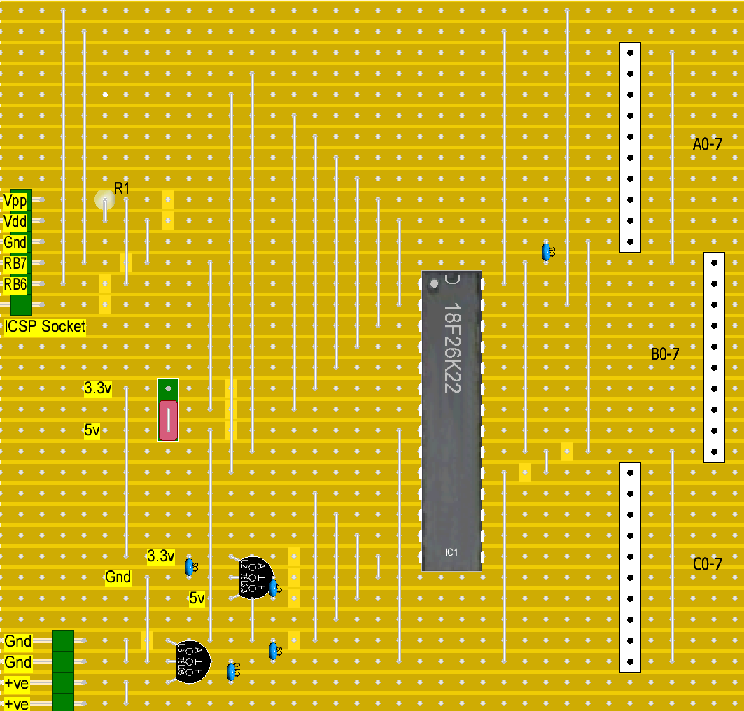

I thought I'd post this, as others might find it useful?. As we've been discussing LCD/TFT usage with PIC's in the Oshonsoft Forum, and the 18F series seemed to be popular, I've ordered a couple of 18F26K22's (chosen for their 28 pin S-DIP package and large memory), so have designed a layout using my standard tutorial board system with ten pin molex connectors. As I'm likely to be playing with 3.3V displays, I've added both 5V and 3.3V regulators, with a link to choose which voltage you want - which saves messing around with level shifters to the display.
Anyway, I've got the board built, plus a connection board for the display (ILI9341), and I'm just waiting for the chips to turn up - I'm 'hoping' they will arrive today, as they were sent via UPS this morning. Basically I'm typing this while keeping on IP camera, that I've stuck in the front bedroom window, so I can see if a van arrives :D

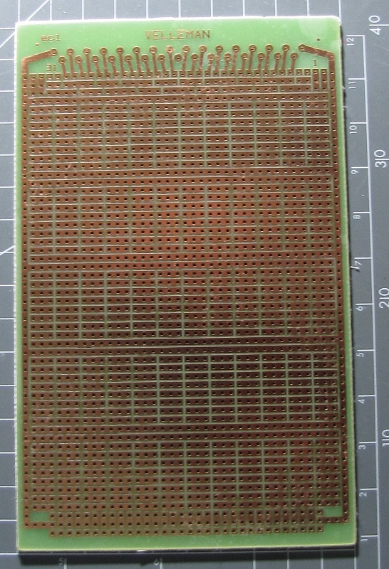

Long live Vero... I've been trying out these Velman IC layout boards, 28 pin IC is a bit of a fiddle as the busses run every 8 strips ( 16 pin ICs ) ,full size a bit big but cut in 1/2 just right....
I reluctantly use those kinds of boards also. But they make me suffer in many ways. Most notably,
1) there's no good places to put a dual-row post header to connect > 8-wide ribbon cables.
2) The groups of 3 holes are too small for me. A standard DIP covers one hole, so one side of the chip has only one extra hole for wiring. Of course it usually takes 2 holes on any pin to daisy-chain a circuit, so that means a lot more wires have to be used to wire one side of an IC. If there was one area that allows for some longer and/or wider chips it would help a lot.

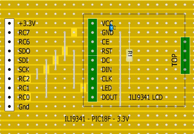

Here's a further board I made this week, an TFT/LCD board for the 18F series - while it's designed for the ILI9341, it will also directly accept a number of ST7735 boards, or a even a 5110 (as long as you have the correct type). And because the 24F series have configurable peripheral pins you can also use it with that as well, just reconfigure the pins to be the same as the 18F. The extra little socket at the right accepts the other side pins of a 5110, or provides support for a larger display.

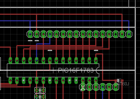

Soldering has not been the problem. Probably the greatest detractor for me is the absence of plated holes. Also, I have a system based on Eagle that gives me schematic capture. Here's a snippet:
Sorry about the quality of the picture. You can probably imagine that it is a template of a standard breadboard on a 0.1" grid. The grid on my screen is barely visible. I do the schematic in Eagle in the usual way. Eagle ensures I have all the connections needed, but not the breaks (shown by short dashes). The "X" marks a pin location on the ICSP header that is not filled ("aux" location). It helps keep me from plugging it in reversed. Dots are unused pins. I then route on the top and solder on the bottom like this:
The snippet is the same section that is in the board layout above.
I looked up Lochmaster after Nigel mentioned it and noticed that it has some sort of connection checker. I was not aware of that, but to me it is a big plus as my mind is becoming like the inside of a pumpkin. If that acts like schematic capture, I will probably try it.
