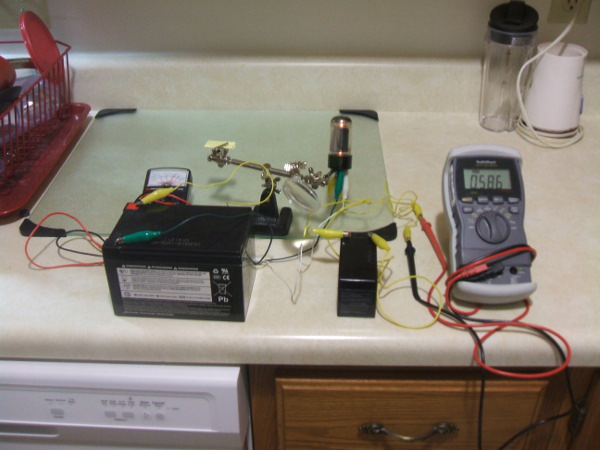

Anyway, I decided to start with the 12D4 Radio Corporation of America (RCA) diode, since it was the simplest on the list.
Filament Test:
Testing the filament was the first step. These tubes seemed to be fairly old, and I'm guessing printed date codes weren't common back then. I honestly didn't know what to expect if the filament had failed. To start, I checked the resistance across the two filament pins indicated by the datasheet (pins 7 and 8). The resistance matched what the datasheet implied. (The filament resistance isn't explicitly called out, but dividing the operating voltage of 12.6 V by the 0.6 A filament current yields the nominal value). The resistance was high enough to seem safe, so I connected the filament pins directly to the 12 V SLA battery...first for a split second, then for several seconds.
Luckily, there were no sparks, explosions, or wormholes created. The filament glows a nice orange, and you can see this along with the filament current in the attached image.
Diode Forward/Reverse Current Test:
I did a second resistance test to check for any conduction between the cathode and anode (plate). There was none, so it was looking safe to proceed testing the diode/rectifier function. I used a second SLA battery to supply the anode and cathode. I could have run the whole thing off one battery, but I wanted to see the filament run independently for now.
The datasheet indicated an anode voltage of +12 V should result in about 100 mA forward current. Sure enough, when I applied the 12 volts, the smaller current meter reported just over 100 mA. Reversing the voltage or applying voltage after cool-down resulted in no measurable current. So I think this one has PASSED.

So far it's going pretty well. I've read a little about tubes in the past, but they really only get a passing mention in most organized courses. I really wasn't sure of what to expect. It's also worth noting I did not restore the tube in any way prior to testing. That is: I didn't clean the pins or remove any dust or debris before-hand. I might clean them on a later date. The pins, batteries and meters were all connected through alligator clip wires.
