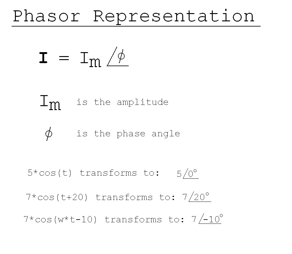

Hi again,
You have two questions, one has a short answer, the other long...
When you ask to transform the source:
u(t)+cos(t)
into 'phasor' form this doesnt make sense because u(t) is not considered
an AC signal, and phasors are for AC analysis. cos(t) does have a phasor
form and that is amplitude separated by a little 'angle' symbol followed by
0 degrees similar to this:
1_0
where 1 is amplitude and 0 is the phase angle, only the underscore is actually
the little 'angle' symbol usually used for phasors.
See the attached drawing for phasor representation.
Did you instead mean you wanted the Laplace or Fourier transform?

Lastly, here is a drawing showing the phasor representation of an AC signal:
