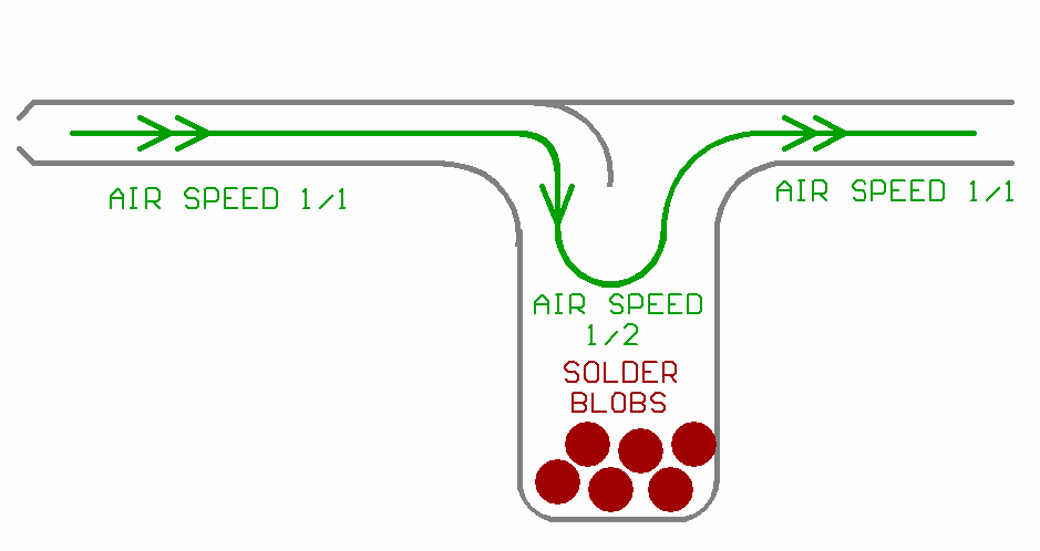

It won't suck the solder through the motor if a diffusor is used. It has the advantage of low resistance to the air stream and solder blobs are separated in a canister which might be a coffee creamer can.
As the air speed reduces the heavy part of the air load drops to the bottom of the can.
See the function from the attached sketch.
BTW, vacuum cleaners transporting dirt over the motor are outdated for quite a while. The sucked air passes through a filter before it continues to the motor, which is normally encapsuled outside the air stream. The motor is cooled on the pressure side of the turbine wheel. Without filter the turbine wheel could be damaged haeavily if solid parts pass through.
