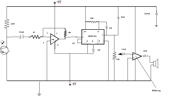

Lm567 as demodulator
Ive attactched my schematic Im not sure if it can be used or not i couldnt get the LM565 to work for some reason so Im trying the 567 . C\an I use the 567 instead of the 565 here ?????
Its 1uF caps are way too high in value and will make it lock only to a 40Hz carrier.
