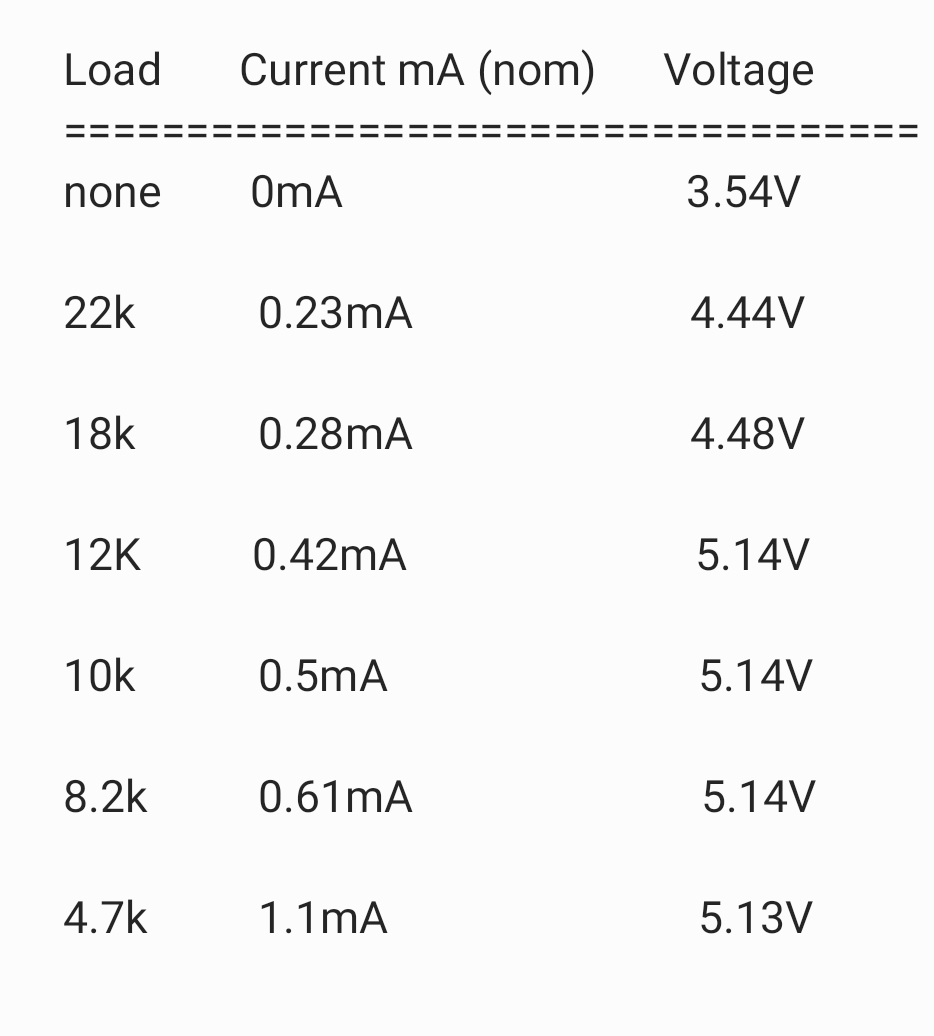

Simple power banks with no power switch and typically with one battery always present battery voltage to the USB connector (presumably the battery protection circuit eventually cuts it off), and when a load is sensed, turn on the DC-DC converter to provide a 5 volt output. Experimental results prove this contention. I connected various resistors across the power bank output (USB connector) while monitoring the output voltage.
The table below shows the results. At some point between 0.28mA and 0.47mA, the DC-DC converter switched fully on, providing 5.14 volts to the USB connector, and will continue to do so until the battery protection circuit cuts off on low voltage.

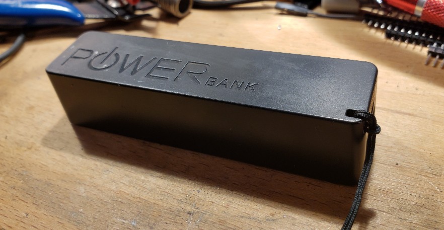

This is the power bank I used, although I have several others of the same type. If there is not a power-on button, a USB power bank will behave similarly to this.
I hope correcting some erroneous information may be useful to others considering this handy power source.
If you have a 5 volt circuit with a low power sleep mode that will continue to operate at 3.5 volts, direct battery voltage could keep it alive at sleep, and the 5 volt supply would turn on when the circuit draws more than half a mA. That may be the best of both worlds.

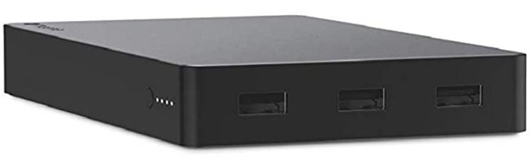

Mophie Powerstation XXL (switched):

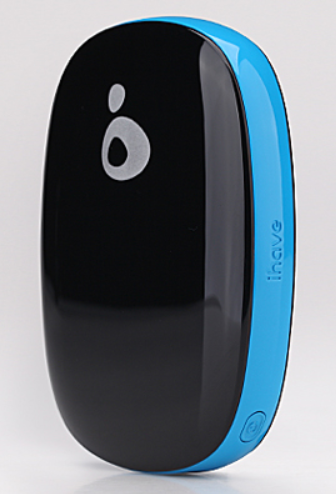

iHave (x2) (switched):

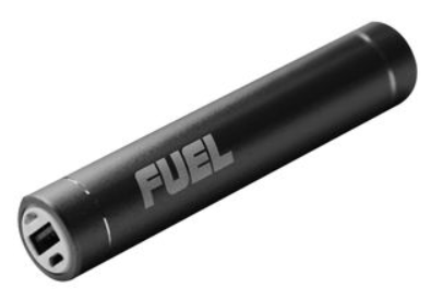

Fuel (unswitched):

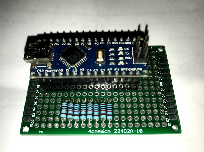

For the cursory test, I powered a Chinese Arduino Nano V3, which simply samples A0 to A7, pulled to GND, and outputs the values to the serial port.......:

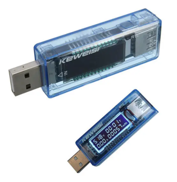

......using a Chinese knock-off of the Keweisi USB tetster:
The simple test comprises the current draw from both the Keweisi tester and the Arduino Nano.
The (switched) Mophie switches off on all 3 of the available outlets - 1A, 2.1A and pass-through.
Both of the (switched) iHave units switch off.
The (unswitched) Staples 'special' switches off.
The (unswitched) Fuel powerbank/flashlight combo does not switch off.
The Keweisi tester, if it is to be believed, shows "0.00A", so less than 10mA.
Unless someone REALLY needs to see what the Nano is actually drawing, I will leave it at that and say that in my experience, with the powerbanks I have, it does not appear that all of one type (switched/unswitched) behave the same.

Just checked and I can get the one shown in the top post locally for AU$5 (~US$3). Time to go shopping. :D

Out of curiosity, I purchased a single cell bank as shown in the top post and used it to power a Nano. It lasted 52 hours before the bank turned off. I'll find a use for it somehow.

The Fuel device switched off.
The iHave devices both switched off.
The Mophie Powerstation XXL switched off using the 1.0A outlet, but charged fine with the 2.1A outlet.

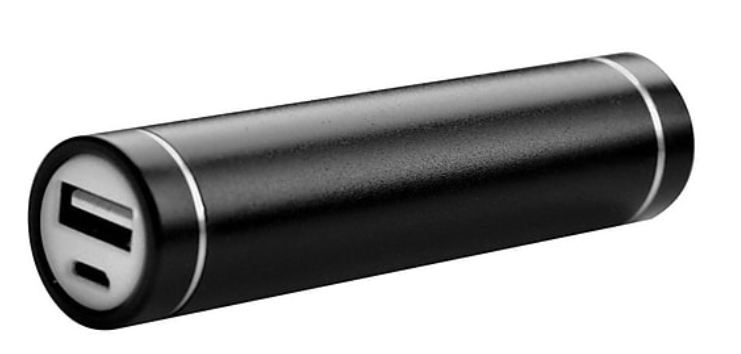

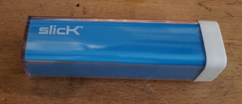

This blue "Stick" battery was charging while I was gone. I expected to read the battery voltage at no-load, but it was zero. It was also zero whatever load I connected. This one is dead.

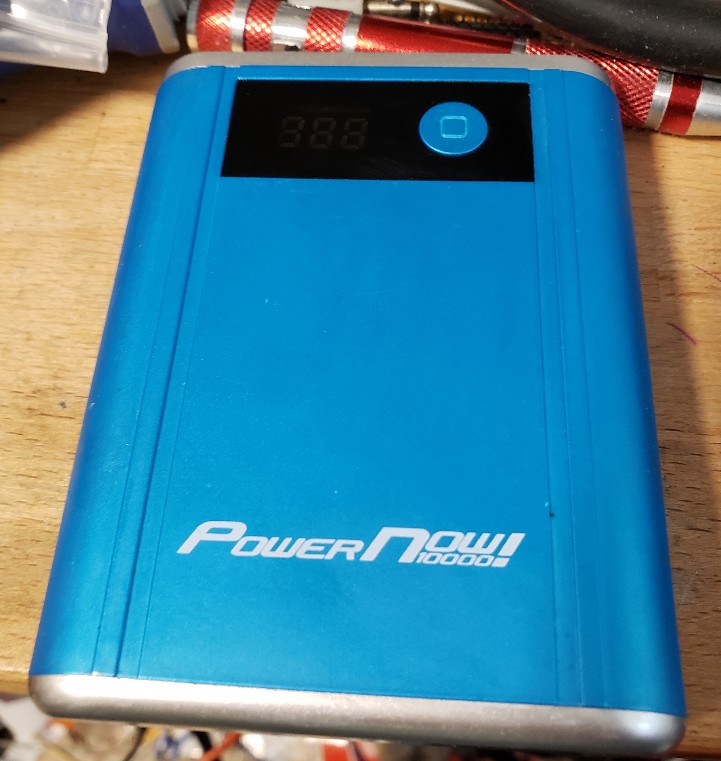

The next test was on this "Power Now" battery. This one has a push button power switch, remaining charge is shown on a 7-segment display and it has a couple LEDs for a flash light.
Pressing the power button with no load, the 5-volt output switches on. About 19 seconds later, the power goes off.
Similar operation with a 330 ohm load (about 16mA), same behavior.
With 2 x 330 ohm resistors in parallel (about 32mA), the 5 volt output stayed on indefinitely.
The threshold to stay on is between 180 ohms (~29mA) and 200 ohms (26mA)
This is exactly as Nigel said, and it's sometimes]/u] true, particularly when there's a power switch and other features. I'll continue my search for some other power banks that are here somewhere.
