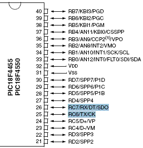

IMHO, the USART is in PORTC and by default all the port pins are configured as input on power up. You will have to make the TX pin as output.
TRISC = b'10111111'
Cheers
Ravi
TRISC = b'10111111'
Cheers
Ravi
The TX pin has to be input for the UART to work properly.
ravimarcus said:
The TX pin has to be OUTPUT for the USART to work properly :). RX pin RC7 and Tx pin RC6.
Cheers
Ravi
Check the data sheet for the 18f4550, I think you will find I am correct.
Please check the attachment. If I am wrong, please tell me where it is mentioned that the TX pin has to be an input. How can a uC transmit if the pin is defined as input?
Cheers
Ravi
It's mentioned in section 20.0 in the datasheet.
The microcontroller will automatically configure the TX pin as an output pin for transmission, but - as Mike said - you set bits TRISC,6 and TRISC,7 when you initialize the EUSART.
Thank you for this information and correcting me. It had totally missed me :). This is a new feature in 18F where the EUSART control will automatically reconfigure the pin from input to output as needed. Normally in 16F we are used to set the TX pin as output.
Cheers
Ravi
A lot of the 16 series chips also require them to be input, even the 16F628A does. I think the only downside to not configuring as input is an increase in power consumption.
Yes, the data sheet mentiones SET. For example I tried this out in MPLAB for 16F877. The TRISC = b'11xxxxxx'. Initialised the UART registers. The TRISC is still b'11xxxxxx'. Practically too I have seen, if the TX pin is not set as output, the transmission will not occure.
For the 18F series, the behaviour is the same in MPLAB. I will have to check it out practically.
Cheers
Ravi
