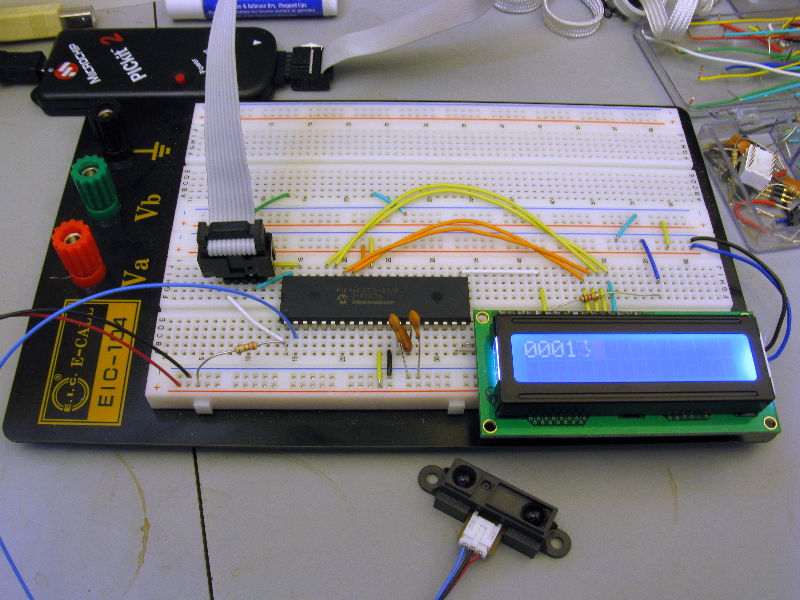

Well engkhlaif, it's not 877A code but it works now. Took me a long time to find a foolish programming error that was messing up the LCD display of the result.
"Final" working 30F4013 code for continuously reading a Sharp GP2D12 and displaying the result on an LCD:

Futz,
I assume the nop is to avoid the RMW problem. Can you do this instead?
	LATB = letter;		//put char in PORTB
	LATB = LATB << 5;	//shift over to output high 4 bits on RB9-12
Ya, the compiler was complaining. Will shifting the bits over in LATB work? So they'll show up in PORTB by the next instruction, right? Sounds like a plan. I'll try it tomorrow. :D
Thanks Mike.
Just had a quick look at the original code.
The main problems I can see are,
ADCON1=7 needs to be ADCON1=0.
The input pin needs to be setup as input.
Assuming the voltage is on AN1 (not AN0) then TRISA needs to be 0x02.
i have done what u say befor as i set ADCON1=0 INSTEAD OF 7
I GET THE RESULT : -24421.138
i dont know why
also i put TRISA=1 WHICH MEANS INPUT AND ALSO THE SAME RESULT MIKE
so what u advice my to do
Which port pin have you got your signal on? Setting TRISA=1 will set AN0 (PortA,0) to input but x=read_a2d(1); will read the voltage on AN1 (PortA,1).
Yup, that works fine. Sped it up and added a proximity alarm for objects closer than ~6 inches.

Now I gotta learn how to properly calculate TAD. I spent an hour scratchin my head and ended up just stuffing in guessed numbers.

Pommie said:
If you have it on A0 then you need to change your code to x=read_a2d(0);
i have done ADCON1=0 and then nothing appear on the LCD is think somee pins are floating so i changed the pins iinto ADCON1=14 then i got the reading constans as while iam moving some thing toward the sensor the reading doent changed it is equal to 17779 i dont now what is this !!!!
this is my code
#include <pic.h>
#include "lcd.h"
#include "delay.h"
#include<stdio.h>
// Setup the configuration word for use with ICD2
__CONFIG(DEBUGEN & WDTDIS & LVPDIS);
void init_a2d(void)
	ADCON0=0;	// select Fosc/2
	ADCON1=0;	// select left justify result. A/D port configuration 0
	ADON=1;		// turn on the A2D conversion module
unsigned char read_a2d(unsigned char channel)
	channel&=0x07;	// truncate channel to 3 bits
	ADCON0&=0xC5;	// clear current channel select
	ADCON0|=(channel<<3);	// apply the new channel select
	ADGO=1;	// initiate conversion on the selected channel
	while(ADGO)continue;
	return(ADRESH);	// return 8 MSB of the result
void main(void)
   unsigned char outString[20];
   float voltage;
   unsigned char x;
    init_a2d();	// initialise the A2D module
	GIE=0;
TRISE = 0;
TRISD = 0;
TRISB = 0;
TRISA  = 0x01;;
ADCON1 = 14;
RE2 = 0;
DelayMs(500);
lcd_init();
while(1) {
      lcd_clear();
      lcd_goto(0);
      lcd_puts("Damn!");
      x=read_a2d(0);
      // lcd_goto(40);
      voltage=(x/255.0)*(5.0);
     sprintf(outString,"A2D = %d volts",voltage);
      lcd_puts(outString);
DelayMs(3000);
when i run it on the board the LCD siplay the folowing: Damn! A2D=17779 vlots !!!!
what is that and why it doent not change while iam moving and object!!!!
Can't help you with C at all, but the ouput of the A2D can only vary between 0 and 1023, so it sounds like your scaling routines are wrong?.
Forget about the A2D input for now, modify your code to feed a fixed number (between 0 and 1023) to the scaling routines, and confirm you get the expected value out. Do this for a range of values, and confirm it all scales correctly - then worry about the A2D reading.
engkhlaif said:
what is the difference between float and decimal and why is that result!!!!
When you state %d you indicate a decimal integer, voltage is a float. Just try it and see.
ok i will try
i want to ask also is that right to write ADCON1=14 as i just need A0 to be analog input as i think if i write ADCON1=0 i set all of them analog and i just want to use A0 !!!!!]
