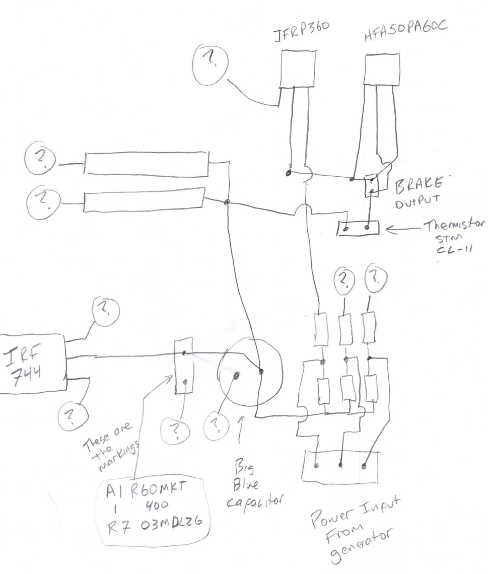

Understood, there's no available diagrams. I can post a diagram what rudimentary connections I've identified. These are components that appear to be in the circuit of the power input from the generator and the output to the brake. It's one of those circuit boards that has the connections sandwiched between layers of the composite so it's difficult if not impossible to trace many of the connections on the board.

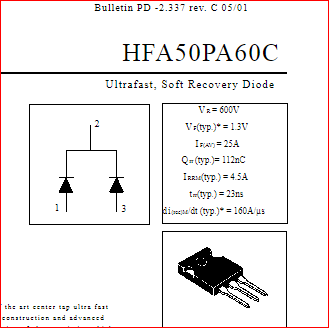

Put black on centre, and Red on Right or LEFT should read the same as Left = 437 +/-10
Diode Test mode is constant low current reading voltage in mV , maybe 2000 full scale.
HFA is just a dual diode with common CATHODE = (-ve) = centre pin 2 so Black always goes to -ve
437 means 437 mV with diode test mode at very low constant current , blank means high impedance overscale or no reading in reverse bias mode.

See attached for my best attempt to draw out the circuit. The ? surrounded by a circle indicates I can't quite follow where the circuit leads next. I'm also not sure what the component is between the blue capacitor and the IRF 744 but have the markings on it written down. Also didn't label the resistors connected to the blue cap and the thermistor.

  • circuit.pdf

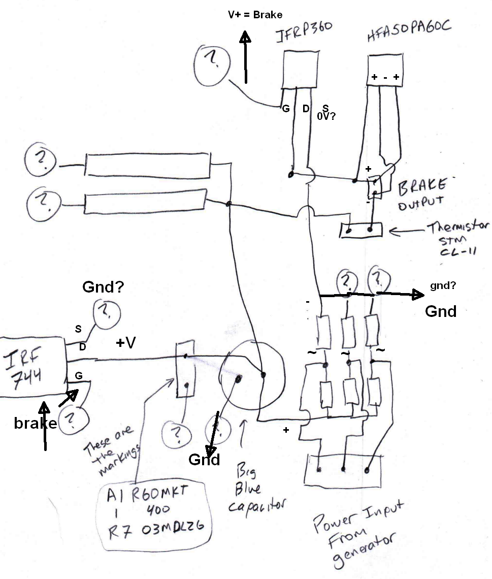

OK, did a little further testing:
Right of drawing where Tony labeled both "gnd?" and "Gnd" does have continuity with ground.

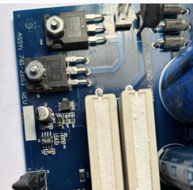

Top of drawing where Tony labeled "V+ = brake", the G terminal of IFRP360 goes through a "small circuit" (see pix of board below); I don't know exactly what to call it. There is continuity from one end of this "small circuit" to the other with resistance (if that makes sense). I cannot tell where the "small circuit" connects on the other end (other end from where it connects to the G terminal of IRFP360.)
This is the "small circuit":
None of the terminals of IRF 744 are continuous with ground. As Tony has labeled the leads to IRF 744 as G D and S:
G has no continuity with Ground or either of the brake terminals
D has continuity with no resistance to - brake output terminal
S has continuity with 494 ohms of resistance to negative brake output terminal
What's my next step?
