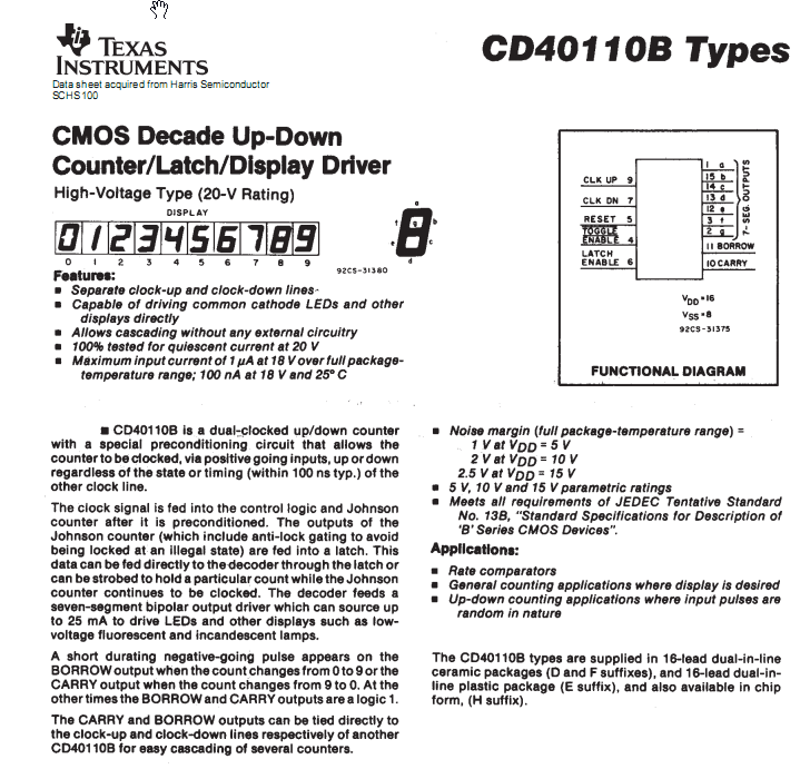

Look at the CD40110B, get the datasheet from Datasheet Archive - Free Datasheet Search Engine :: PDF Datasheets :: Data Sheet :: Datasheet :: Application Note : ??? : ??? : ???? : ????? : ??????? : Fiche technique : Datenblatt : ????????
Its a BCD Up/down counter with 7segment LED driver. OK.?
