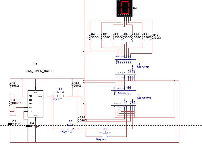

I was finally able to make an 1 bit up down counter but may problems is that when I reach 9 and fed in the up clock using the push button the display should still be 9 but it keeps looping back to 0. The same problems occurs when the display is 0 and I fed in the down clock. Any suggestion on how to fix the problem?
Here's a picture of the circuit I made, the supply and ground is the only part cut out from the pic

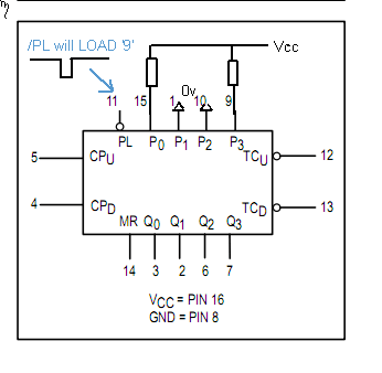

One way is to use the Parallel load option of the 192, reload with a '9', when '0' is detected
E

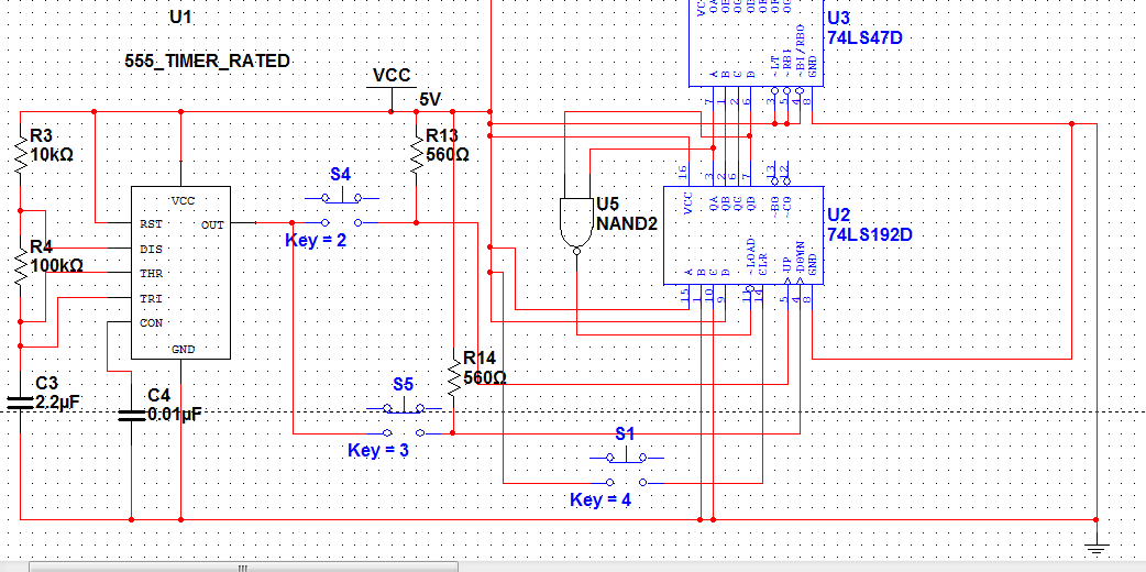

I tried using a /PL load '9' it doesn't loop to '0' anymore but now I can't count down
The /PL has to be a pulse Low when loading the '9' ,,, at other times it must be High.
Repost you circuit showing how you have connected the /PL pin.

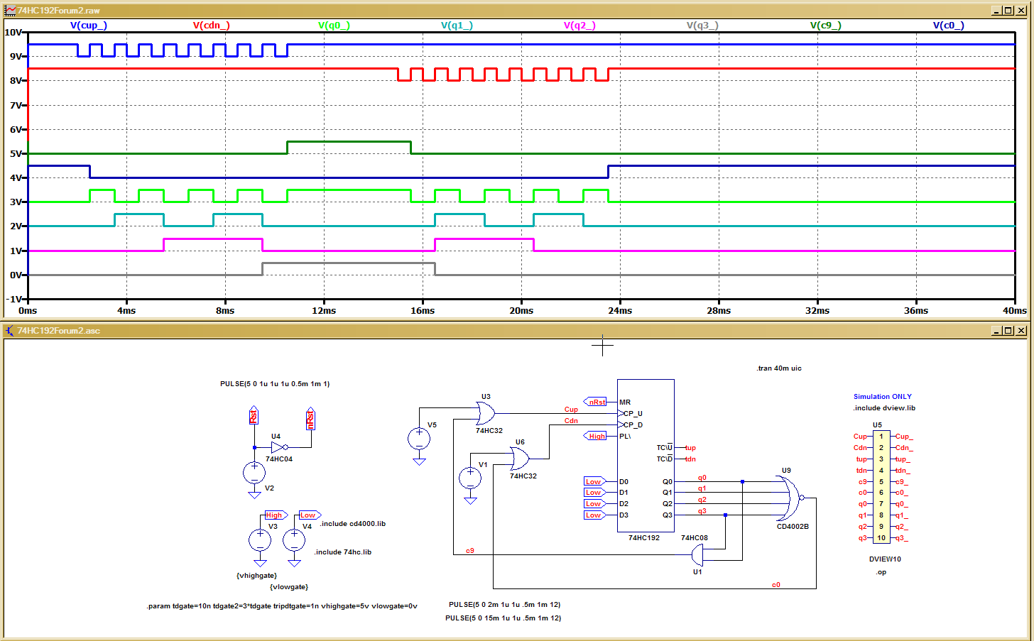

Look at this option, it works in simulation OK.
Note for testing I have clocked the Up and down 12 times to show that it ignores greater than '9' less than '0'
I use a CD4002 as I do not have a 4 input NOR model in my LTSpice.
