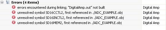

Hi All,
I'm getting the following errors below but can't figure out what's wrong. Does anyone have any ideas why you could get such an error? I know the linker takes all the machine code and puts it together in a standard order. hmmm.
-mike
Each source file in your code will be compiled into a object file (.obj) and the linker will link all these object files into a single output file.
Linking failed because the objects "SD16CCTL2, SD16INCTL2 and SD16MEM2" wich are beeing used in ADC_Example.obj (wich is the compiled version of your sourcefile ADC_Example.c or .asm or whatever language you use) are never declared.
What platform is this on?
thanks EXO
You're right. Thanks. They were never declared in my .h file for my specific chip. After inspecting the .h file I found that I was using the wrong one. I was using the MSP430F427.h file when I was supposed to be using the MSP430F4270. I was tricked because when I toggled my LED(to make sure I could at least program the chip) everything worked fine. Then when I started to do something usefull(read a port pin) it hickuped.
