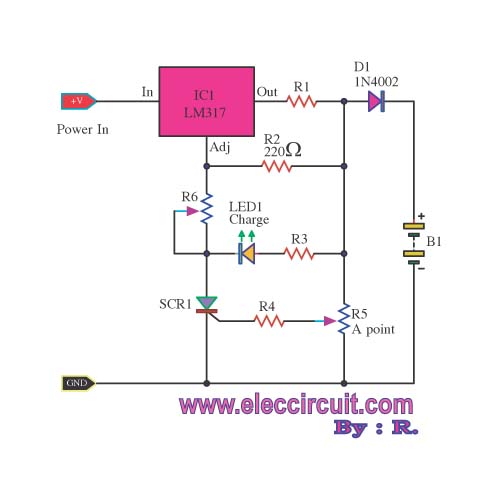

I found this on the web:
The principle is that the ADJ pin current path is initially ungrounded so the charge rate is initially current limited (set by R1, ~1Ω). When the battery voltage reaches a pre-set limit the SCR fires, grounding the ADJ pin current path, and the charger then operates in pre-set voltage mode.
This could be the basis of a smart charger.
The problem with that circuit is that the series resistor is still in circuit even in voltage regulator mode, so it drops volts and the regulation will be poor.
Putting a resistor in front of a simple LM317 voltage regulator will still limit max current but allows perfect voltage regulation at other times.
Even better, the old trick of one LM317 as a current limiter, feeding a second LM317 as a voltage regulator. That gives excellent current and voltage regulation and only needs the two regulator ICs and 3 resistors + caps. :)
