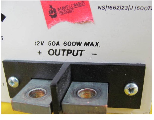

I guess so. I was just hoping that there would be a way to change the voltage out without tinkering about inside the supply.
The eBay user got back to me, and said just attach a 50k variable resistor to terminals labelled 'prog' and '+'. this allows me to adjust the voltage out.
I'm not sure though if this will allow me to draw the full 600W at 12V. i imagination not. you mentioned the possibility of a 48V to 12V converter and that there are plans around for it, could you point me on the direction of one please?
I would try the 50K pot idea first - no reason I know of why it should not give full power if it works at all. I hope it does :)

i have just tried it with the variable resistor - i had a small 50K one, with that i get about 2V to 50V. Very pleased with that. However it is way to small. I popped down to Maplin and bought a 47K one, (that can be mounted onto the side of the case) , the closest thing to 50K they had, and i get a range of about 4V to 40V. Interesting where the missing 40-50V go but after all i don't' really mind as 50V is way to high for anything i would want to use it for.
As you said, 600W is alot to play with. At 12V that is 50A. The reason i want so much is i want to use the supply in a sorta DIY UPS backup system. Not entirely sure how i will set it up, but i have a 600W 12V to 240V inverter, the idea being that the power supply charges several 12V batteries all connected in parallel, and off them runs an inverter. When mains is on the power supply runs the inverter. When mains fails, the batteries take over. As the inverter is rated at 600W that means it will draw up to 50A into it. not that i think i will ever use the 600W fully.
This is all just a rough idea that i have, but in the end after all what is there not to like about a variable 0-50V DC Power supply rated at 600W? i'm going to have fun with this :) i can see it now, cranking up LEDs until they go bang.. hm..
The one thing i wonder about is that if the front output terminals can handle 50A or not.
this is how the 12V version looks. a bit more beefy huh?
Anyways i dont' think i will be drawing 50A for long periods anyway.
Hooray! All without having to understand what goes on inside! Still, a learning experience anyway, eh?
You are right, the output terminals are only rated for the current of the supply at 48V, and whatever wiring internally goes to them will be similarly smaller, also, whatever components are feeding into that will also be de-rated in the same proportion. So be very careful when you drop the voltage, if indeed it can sustain the same amount of power. You don't want to fry anything, power semiconductors are expensive, and obsolete semiconductors may be impossible to replace. Same goes for the power transformer too.

but that doesn't matter really now as the ebay user got back to me, and he says that they can only handle the max current 12.5 A no mater the voltage. So yeah. Not bad though. a 0-50 DC power supply offering 12A. lovely.
