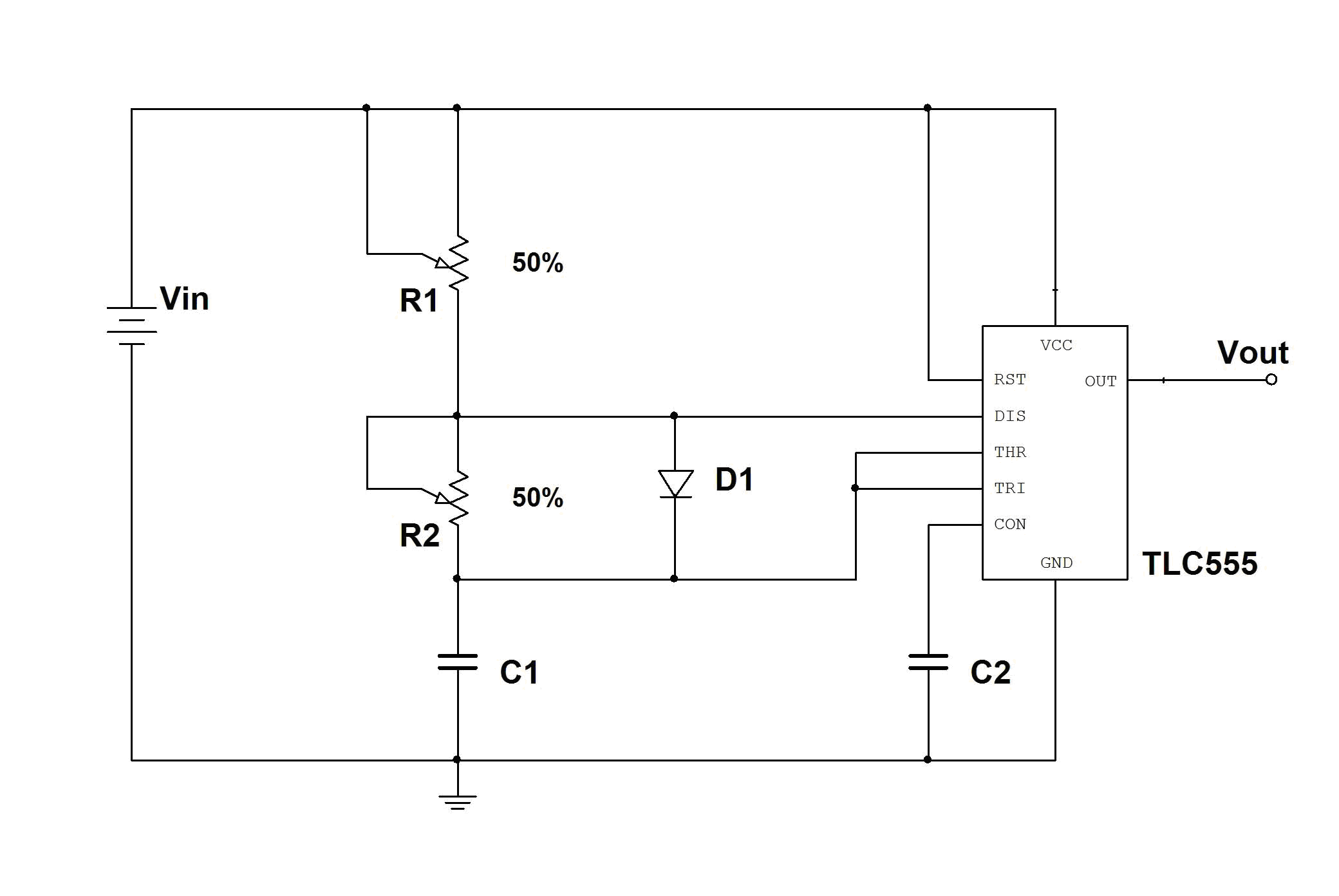

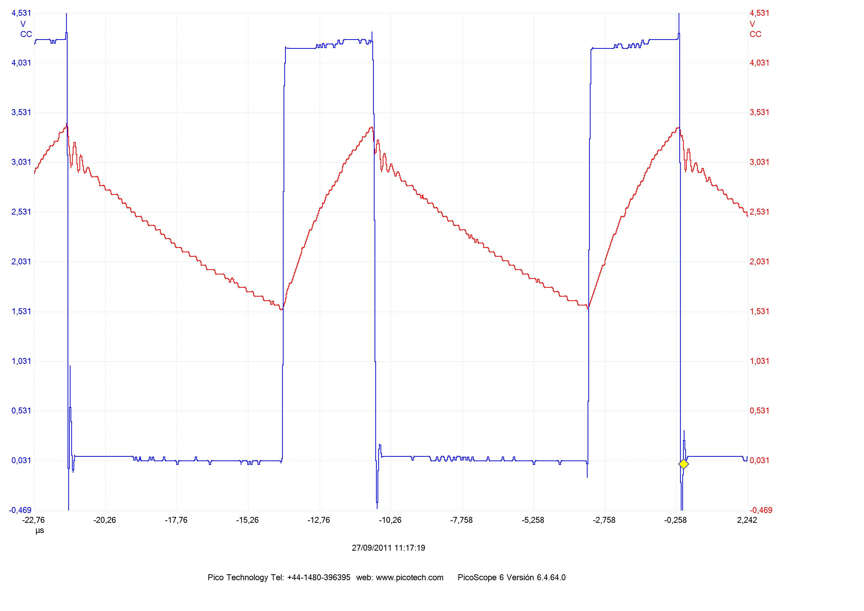

I made a circuit for generating an "square wave" signal with adjustable frequency and Duty Cycle. For me is enought to be able to regulate Duty Cycle manually adjusting some potentiometers. I call this a PWM (I know it is no exactly one).

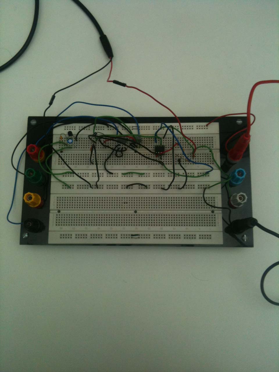

I attatch you the circuit schemattics (Esquema12.png), a foto with the protoboard (Foto1.JPG).
Vin: 5 V
C1: 2.2nF
C2: 0.01 uF
R1: Potentiometer 10K
R2: Potentiometer 10K
D1: FS 1N4934 (max trr 150 ns)
The circuit is adjusted to produce a 100 KHz frequency and a 30% Duty Cycle.

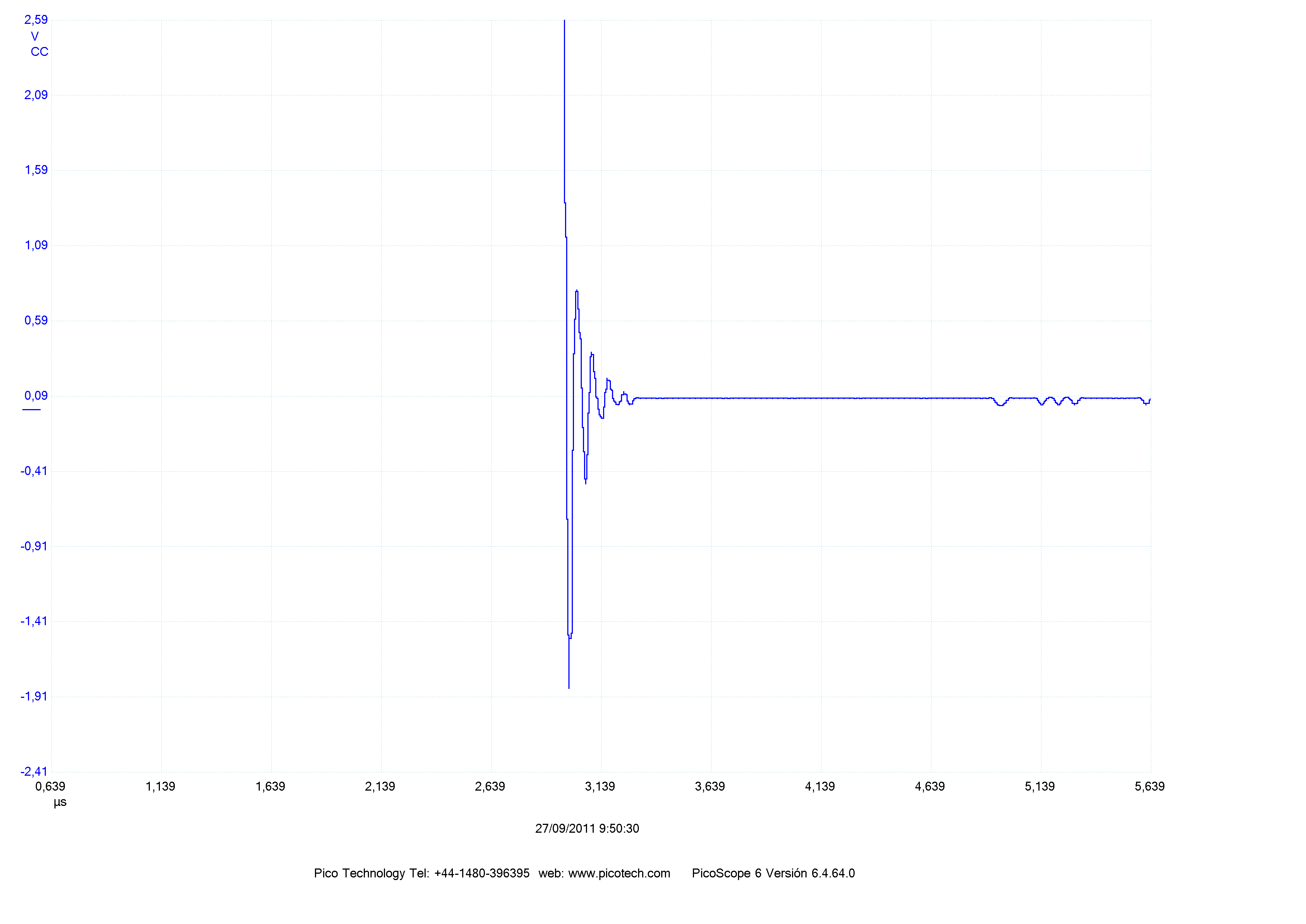

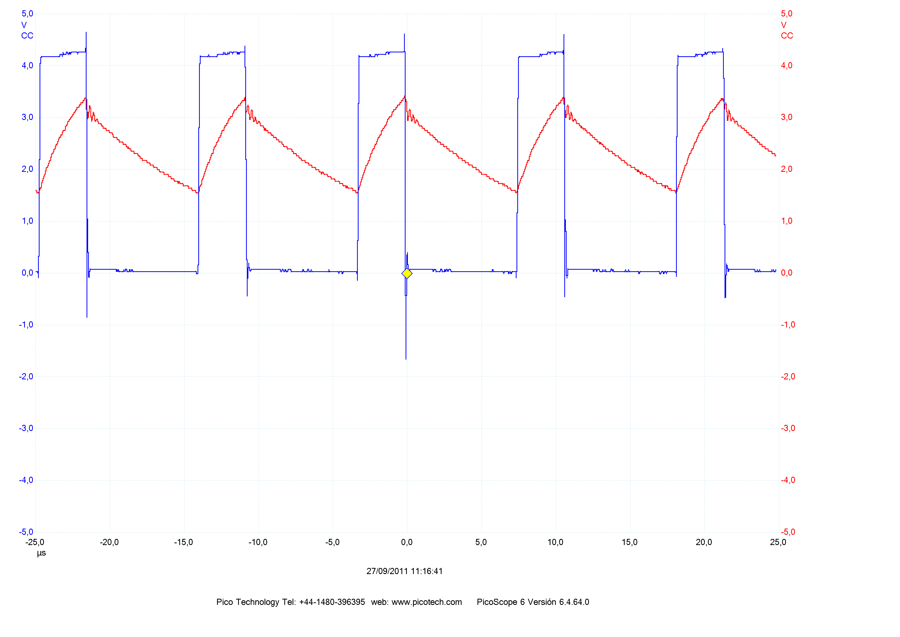

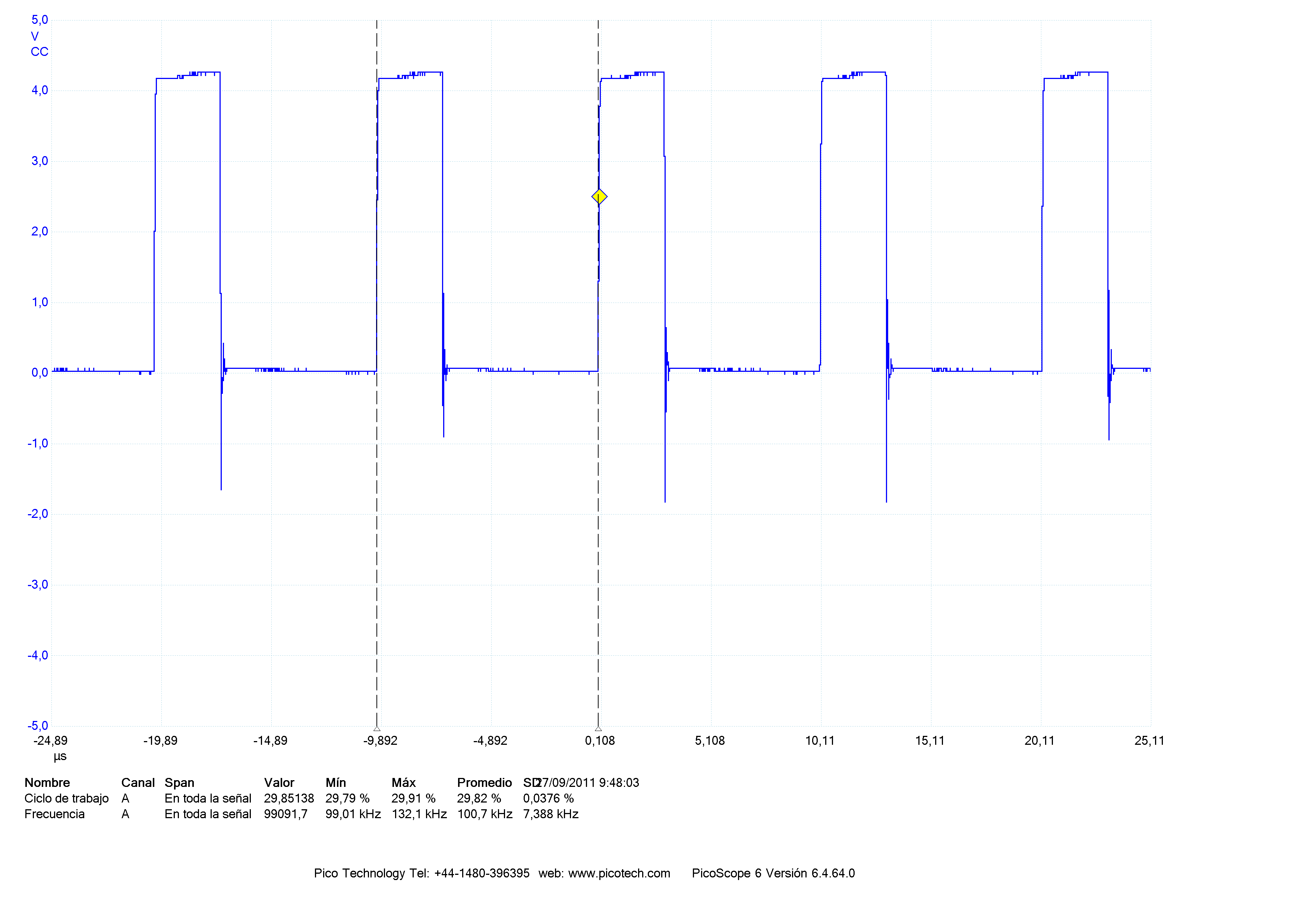

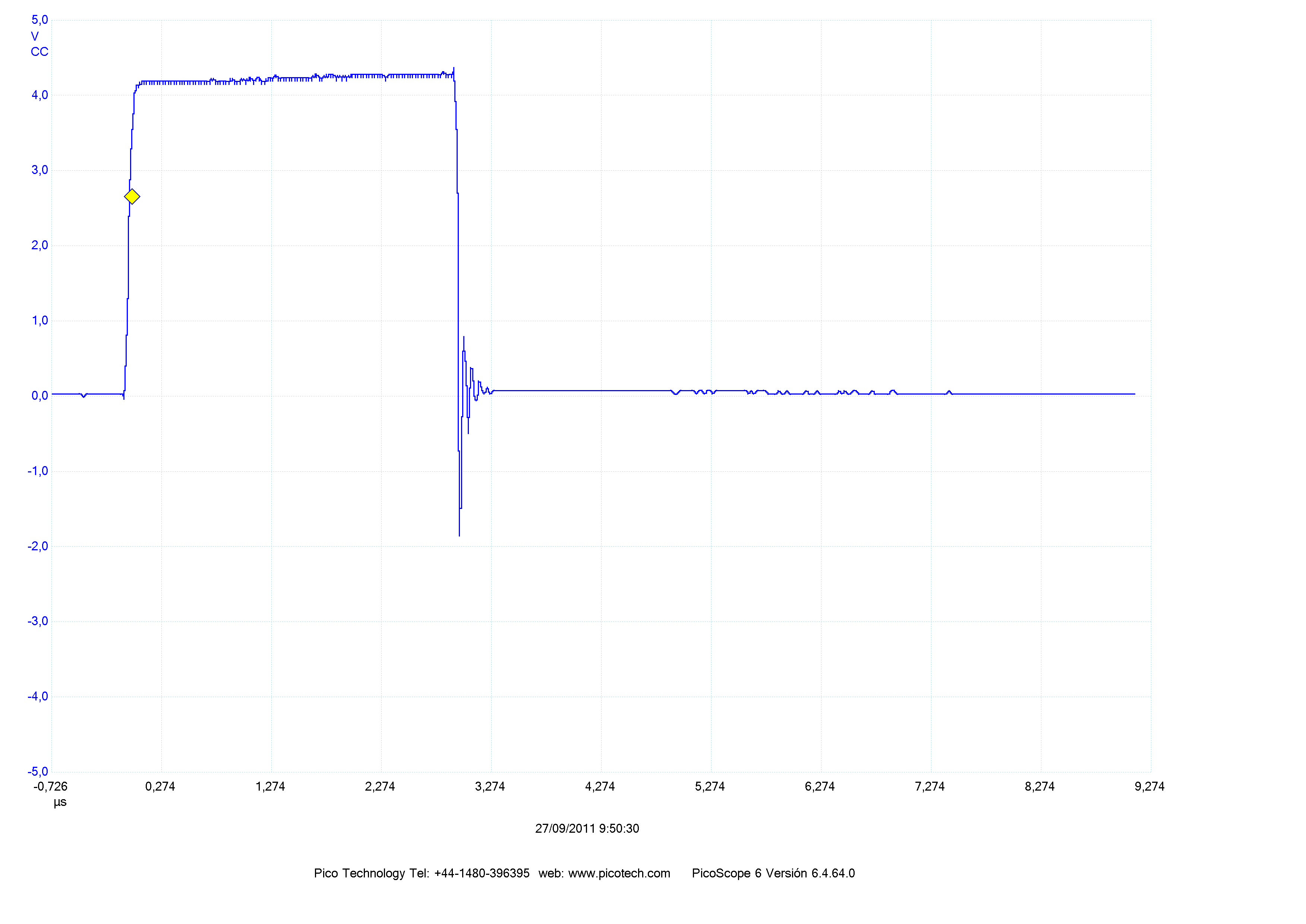

I attatch some captures of the osciloscope (Picoscope 2203): (Esquema13.png to Esquema17.png)
My problem is that I've discovered a little ripple in the output (as you can see in Esquema15.png). I think that's produced for the oscilation in the capacitor (as you can see in Esquema17.png).
As you can see, the problem is only present in the fall time, because the rise time is perfect! Intuitively, the problem occurs when the threshold input makes the output low, but I don't know how to eliminate this oscilation!

When the 555 starts to discharges C1, the stray capacitances on the discharge pin are discharged very quickly. The current is very large, so there is ringing in all the stray inductances as that current starts.

Each wire on the breadboard is an inductor that produces voltage spikes.
Each connector strip and wire on the beadboard has capacitance to other connector strips and wires that add to the inductance of the wiring and make ringing LC tuned circuits.
Hint: Get rid of the breadboard.
He could also try shortening the jumper length a bit. He may also try to add an output filter with a 1k resistor and a 10nF cap to smooth the signal out a bit. I'm not 100% on how that would affect the circuit, I'm just throwing some numbers out there.
I think that the "ripple" could be due to the way the circuit is built and how you are measuring it.
(A better word for the "ripple" would be "ringing". That is the usual expression for oscillation following a sharp change in a waveform).
You are running the circuit at quite a high frequency (100khz), which means that the ringing frequency will be several Mhz.
The circuit is built on a breadboard which itself is not good at high frequencies.
There are long wires connecting the various parts of the circuit, the long wires will have inductance.
The connection to the picoscope appears to be a simple twin wire cable rather than a low capacitance high impedance scope probe.
The twin cable will have significant amounts of capacitance, and inductance.
So, if you want perfect edges on your square waves, build the circuit on a low impedance ground plane with short connections, and make the measurements using a divider probe (divide by 10) for the scope.
Hi. I'm kind of used to test circuits on bradboards. The wiring itself is awfull and it's a great chance that fixing those will be the solution. See my atached figure.

I have built such circuits like that and more worse of a ratsnest than you can imagine,still have not encountered such ringing,except possibly when using just a piece of cable that was uncompensated.
Try using a regular scope probe and see if that will help,if you don't have one there are very easy to make.
I do remember trying to use just a piece of cable once and the results where very bad for square waves since then I have always used my probe.
It was a very long time ago so I don't remember the details.
I have used just a piece wire from the BNC on the scope with good results but this is more susceptible to external RF noise but I have not had ringing issues using this method.
just a few thoughts. jer :)
You might also want to add a decoupling capacitor from Vcc to ground close to the IC.
I have. And also I have some storys with rat nests. In at least two particular cases that I remember, straighten up the wiring did solve the ringing problem.
Thank you everybody for your answers. They are focused in perfectioning circuit construction. I will do it.
Don't you think is a possible problem of the trr of the diode? Maybe a capacitor in parallel with the diode?

I've ordered two new probes and I'm reconstructing my circuit. I think is the best advice to begin with this!!
