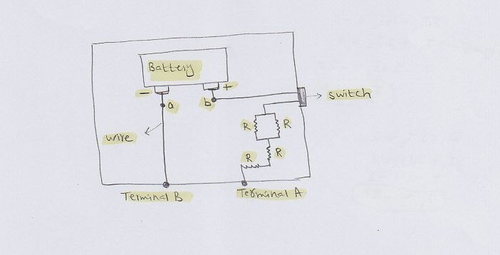

Hi again, :)
I'm trying to understand how a circuit is thevenized practically. Please have a look on the attachment. When the switch is pressed one can measure the voltage on the terminals 'A' and 'B' by connecting a voltmeter. In theory it is said to short the voltage supply and open the current source. I believe in this case it would mean that disconnect the battery's terminals from the rest of the circuit and connect the points 'a' and 'b' with a wire. Then, connect an ohmmeter to the terminals 'A' and 'B' to note the equivalent resistance. Am I thinking along the same lines? Please let me know. Thanks a lot.
Regards
PG

PG,
There are terabytes of information on applying the Thevenin method. Nobody wants to explain it all over again.
Ratch

Hi Ratch
I know how to apply Thevenin theorem theoretically. I was trying to understand how it works in reality. By the way, the reason for there exists terabytes of information is that we all learn in different ways! :) Thousands books of a library cannot substitute for a teacher or knowledgeable persons like you and many others.

PG,
All right, submit some nontrivial problems so we can show you. Try to include independent sources, dependent sources, and a mix of the two. Again, don't make them so easy that they can be done by inspection.
