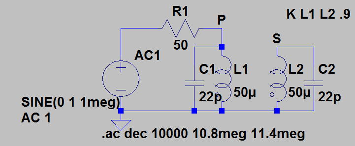

I've already seen both of these articles but neither one gives any analysis of how the phase shift happens, just that it does. Although the second one does imply that loose coupling between primary and secondary is a factor. To simplify the circuit I'm interested in just throw away everything but the transformer and the capacitors across the primary and secondary and add a source and a simple load.

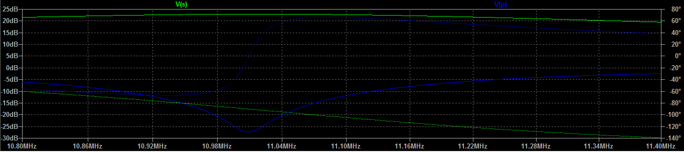

I built this in LT Spice. Primary to Secondary coupling is 0.9.
L1 and L2 needed to have the Q reduced a little. I added 1 ohm inside L1 & L2.
The dark blue line is gain for the primary. Light blue dotted line is phase for the primary. Note the phase reverses near resonance.
The dark green line is gain for the secondary. Light green dotted line is phase for the secondary.
Right in the center of resonance it does appear there is about 90 degree shift.
A loosely coupled coil is molded by adding "leakage inductance". So there is another inductor that is not on the schematic. I think that inductor adds phase shift.
