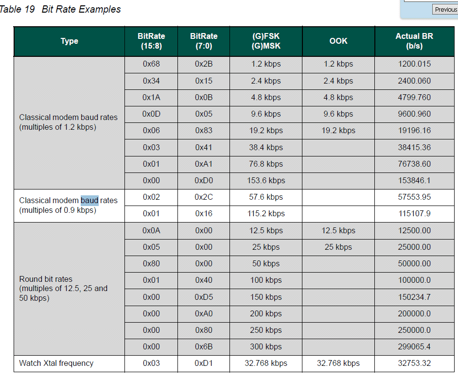

having the speed to accept an incoming sentence on the fly?
IIRC you are programming the TX as well the RX ends of the LoRa radio link, so why are the rates so high.??
You can select a lower rate.??
E
E
Hi E,
Well spotted, however, I notice that this is in the FSK/OOK not the LORA section of the DATA sheet. I would have to double check whether this is relevant. You will notice that the LORA sections are in light blue. Having said that, there are some shared sections. A DATA sheet to send you mad:arghh:
EDIT: I searched, and don't think this is used in LORA MODE.
C.
