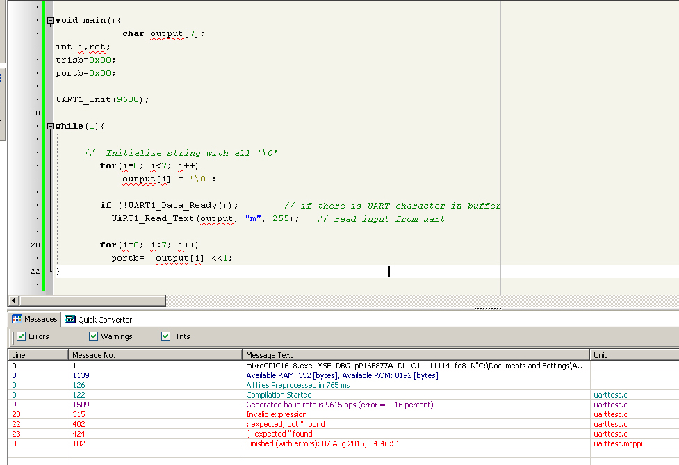

I want to interpret uart string as binary values, i have made a code but not compiling
void main(){
            char output[7];
int i,rot;
trisb=0x00;
portb=0x00;
UART1_Init(9600);
while(1){
     //  Initialize string with all '\0'
        for(i=0; i<7; i++)
            output[i] = '\0';
        if (!UART1_Data_Ready());        // if there is UART character in buffer
          UART1_Read_Text(output, "m", 255);   // read input from uart
        for(i=0; i<7; i++)
          portb=  output[i] <<1;
What errors does your compiler tell you? Also post the whole file, not just parts.
Ok, so your code really is that short. So once again, what errors is your compiler telling you?
some syntax errors, but i am not seeing any errors in the code
attached the screenshot
The while statement isn't complete there is an end brace missing "}"

      } //<---- HERE
