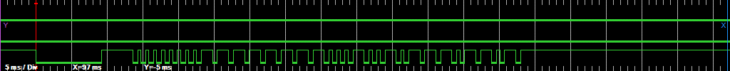

More back to the topic though, I have slowed down the clock and 0 'd osctune, and then re-calibrated my timed operations,
I am able to receive and decode my remote pulse codes, however repeating them is still somewhat of a problem..
to debug i have traced the original pulse code on the scope that is going into the TSOP (TSOP IR RX is on INT0 pin, and echoed in TMR0 interrupt)
then i use a mirror to reflect the IR that my device is trying to echo, back in to its own TSOP and trace that on the scope
so far I am able to confirm that the pulse widths are in good .... fairly accurate timings...but the LG TV is still ignoring the instruction. Also it difficult to trace the full pulse code since it is so long
One problem in my code I can think of is that my read variables are 32-bit , while the actual pulse code is 27-28 bits, which would add a few unnecessary 0-pulses on the echo... I'm thinking maybe I need another 8bit variable that will define the terminated position... since i cant store a 2 as terminator in the 32-bit part ..... maybe there is a trick or other idea?
Again other things I fear here are timing, accuracy and wonder how much each of the pulses on/off times count ..... any chance someone has done this before /or has ideas? Or foresees other things im up against?

Transmitting IR is pretty trivial, and I've done numerous different types - but not LG (as far I know - I'm not sure what scheme LG use?)
The IR code in my tutorials is pretty easy to alter, and I've used that as the basis for my various transmitters.

The whole point of the coding systems used is that exact timing doesn't matter, as the IR link completely changes it anyway - by quite a high percentage sometimes.
Subroutine calls don't make any difference because they are only microseconds, far too small to have any effect.

genius Nigel! I forgot that these would use a standard "protocol", so i searched it! LG uses the NEC protocol! Which adds another mystery of why i only received 28 bits!
I will do up a sub to follow the protocol better and see if transmitting is then more successful. I think my worry was mostly about pulse time accuracy. (things like the protocol says 540us, but actually I was delaying 600us .. its difficult for scope to get zoomed in that close and use the one-shot ... mostly cause of the long start bit)
I did the NEC protocol for a local theme park, to add manual buttons to small media players that only have remote control operation.
I simply wired a PIC to the back of the IR receiver, and inserted the data directly - the IR remote still worked as well :D
Quick edit: - I used the PICKit2 to capture the signals from the remote, in order to identify what I needed, here's one of the keys, this is actually the power key:
Like I said before, it doesn't matter, the output from the receiver won't be anything like the timing from the specification, and will vary with distance from the transmitter as well.
