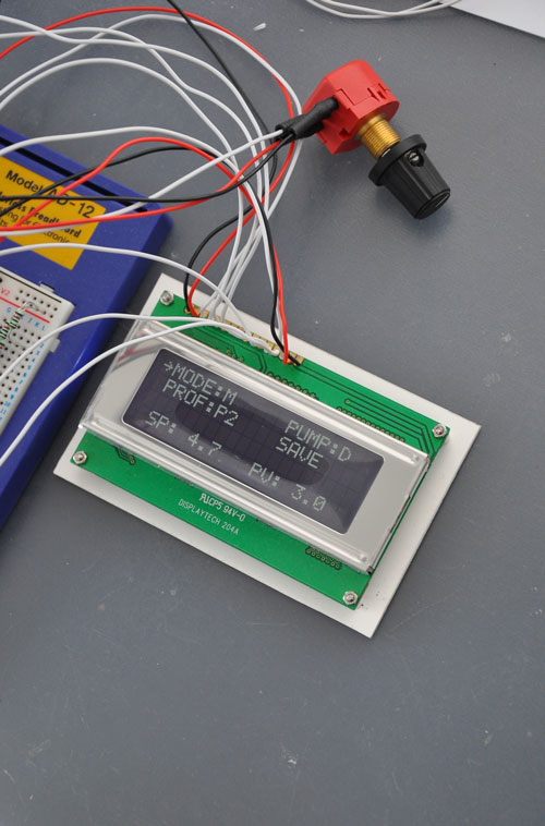

Hi guys,
first of all, Nigel's website seems to be down:
so I thought I would ask on the forums.
I'm using a PIC16f877A and I've configured it to read two ADC inputs on pins 0 and 1 of PORTA, there's also a Vref+ on pin 3. It all works well when I'm reading from one source at a time, but when I try to read from both of them, one after the other it goes sideways and I'm getting strange values on the LCD (which is hooked up to the PIC). The two analogue inputs are pots, one 10k and one 0.5k as they were the only ones I had at hand.

Now, what's happening with both pots active is that when moving one pot the values shown for the other one are changing as well. The display looks like this:
One pot controls the SP value and the other one changes the PV. With both analogue channels active when I change the SP the PV changes as well and vice-versa. It's not random numbers, when I turn the pot 'up' the values increase etc. Also when I set the SP pot to max the PV pot works as it should, if I set the SP pot to 0 the PV pot shows only part of the full range of numbers it should (should go from 0.0-9.9, but goes from 0.0 to 2.6 only).
I tried putting a delay (5ms and even 500ms) between the SP pot read and the PV pot read, but it changes nothing. When using a 500ms delay between the two reads I've noticed that first the correct value changes and then it also affects the second value which normally should not happen (as it's controlled by the second pot). It looks like there's something left in the ADC registers, as if the conversion hasn't finished yet, but that can't be as I'm checking the DONE bit before processing the values.
Perhaps someone here had a similar problem or sees something obvious that I've missed? Would appreciate any help. Thanks!

For the rest of your problem, you're switching ADC channels and reading it immediately - this makes both inputs read wrong, you need to delay after switching channels to allow the sample and hold capacitor to charge/discharge. Try my tutorials again, which explain it all.

I had another look at the code and I was indeed reading the data two fast after switching channels. The delays I've tried before were used outside of the Read_pot/PT routines which means they simply delayed the read from two sources instead of delaying the channel switch and actual ADC read. I've placed 5ms delays after switching ADC channels and now it all works well.
Thanks a lot for all the help and for your tutorials Nigel!
Oh I also switched to left justification.
