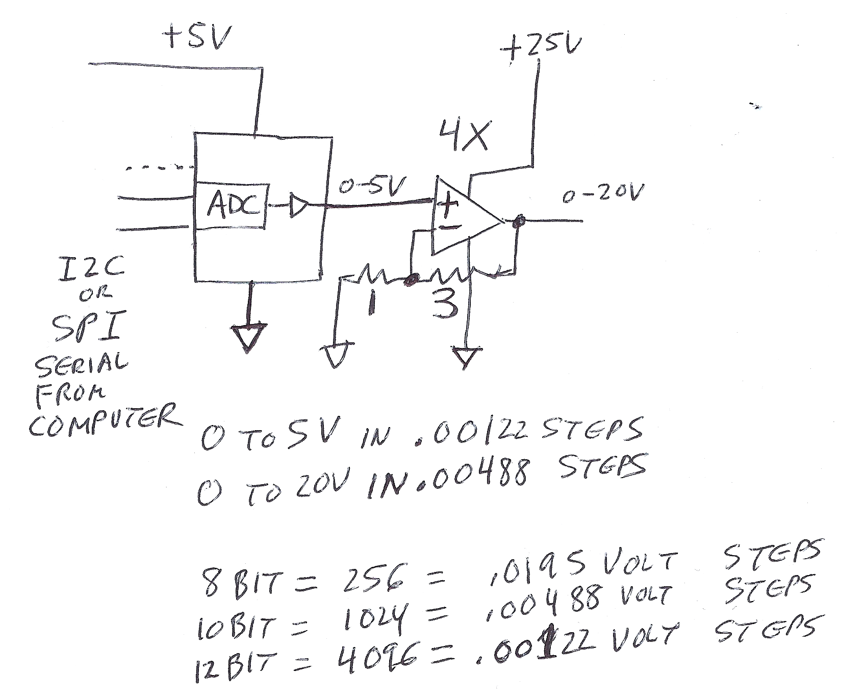

If I was doing this (not that we really know what you want), I would use two 8 pin ICs and two resistors.
The DAC is any 6 or 8 pin serial DAC. The op-amp simple.
First make any voltage from 0 to 5 volts in 1mV steps.
Amplify by 4.
Now you have 0 to 20 volts in 4mV steps.
(edited)Should say DAC in the picture.

I don't understand the problem. A 14 bit DAC can be had for under $5 and will easily give the accuracy you need with Ron's suggestion above.
DAC: MCP4725, MCP4726, MCP4921 There are many others like these.
I looked for a op-amp that has a supply voltage of greater voltage 20V. I want a R-R output so you can use a 20V supply and the op-amp output can go from 0 to 20V. (most amps can not do that) The input range needs to be 0 to 5V. (most will not go to 0) The first amp I found is OPA192. There others but you can look for them. .

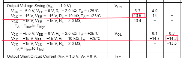

So the example here show a (+5, -5V) and a (+15, -15V) supply. With 2k and 10k loads. We can learn that the output can not get to the (+) and (-) supply. 1.4 away from plus and 0.4 away from the negative supply. (that is why I looked for a R-R amp)
In this case; to have an output go from 0 to 20V you need a supply larger than 0 to 20V. (maybe -5V and 25V) or (-3.3 and +25)
In a diff amp usage, does Vicr=Vcc-1.8 and Voh=13.6 (ie 1.4 below the rail) matter? Both cannot/neither can reach the rail by almost the same amount.
On the flip side, Vicr=Vee(0V) but Vol=0.1-0.7V is more "unfortunate" (not sure of the right word).
