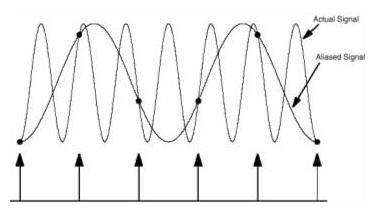

Digital scopes can alias. Older digital scopes really have this problem. This picture shows a fast signal that the scope samples at a slow rate and displays a much slower picture that is not correct. This happens when the sweep speed is set slow and the waveform is fast.
