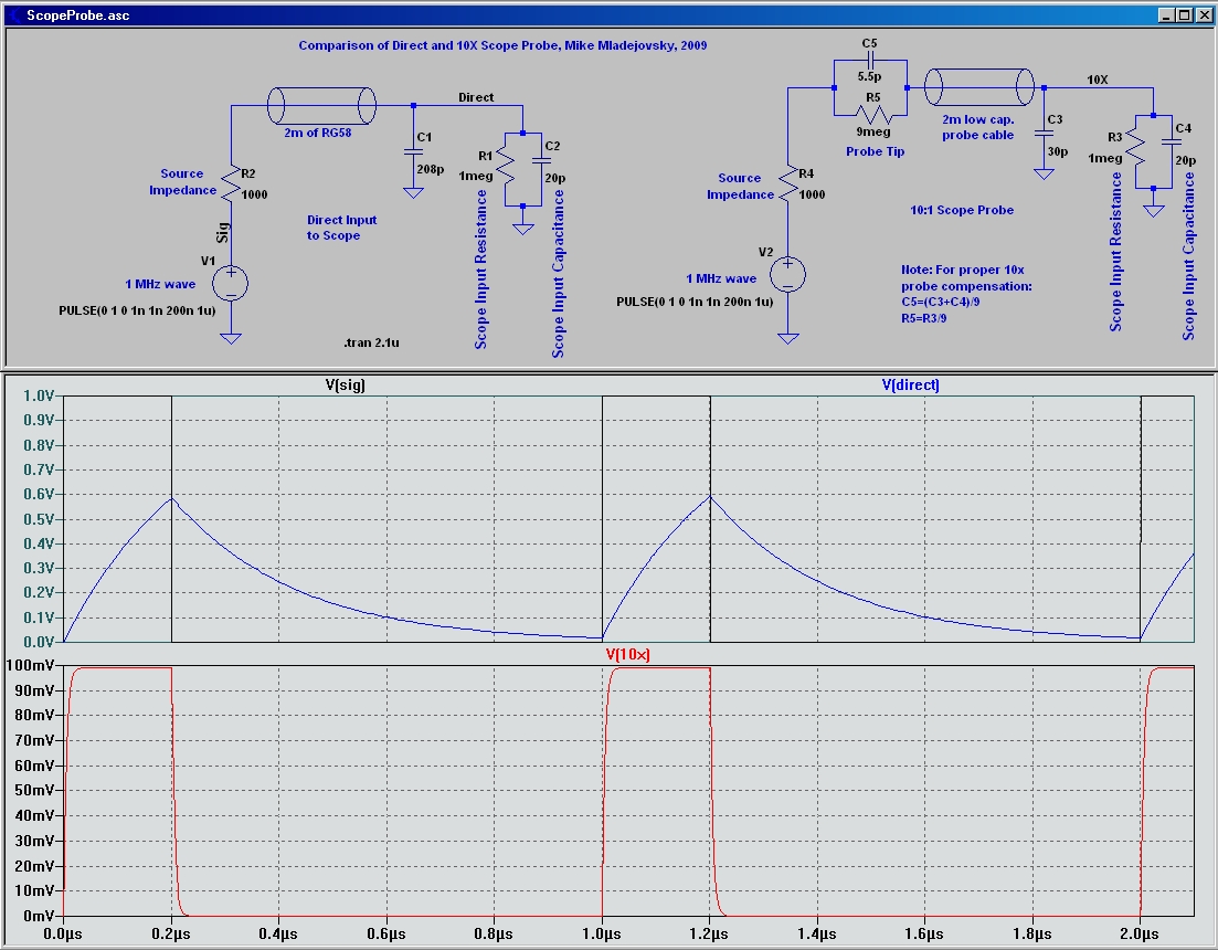

Suppose you have a transistor circuit you wish to measure. The circuit generates a 0.2us pulse, repeated every 1us. The circuit has an impedance of 1KΩ, meaning that you will "load" the circuit if you connect a measurement device which has an input impedance of much less than 10KΩ.
You have a standard 10MHz O'Scope, which has an input impedance of 1megΩ and an input capacitance of 20pF. So Far so good. You need to get the signal from the circuit to the scope, so you grab a 2m piece of RG58 coax cable with clip leads on one end and a BNC plug on the other. You observe a waveform.
Now you repeat the measurement using a 10X scope probe with a 2m cable; and behold, even allowing for the one tenth amplitude attenuation, the signal doesn't look much like the previous measurement.
Why are they different?
Look at the attached simulation. See if the light bulb goes off??
The 9Mohm probe resistance increases the scope input resistance by a factor of 10:1. The probe parallel capacitance is adjusted to give a similar 10:1 decrease in the input capacitance (increase in capacitive impedance). Thus if the probe capacitance was adjusted to 9pF for optimum square-wave response, that means the stray probe cable and oscilloscope input capacitance are a total of 81pF.
If the two capacitances are constant with frequency, then you will have a voltage divider that is 10:1 over frequency. You have a resistive divider in parallel with a capacitive divider with the same attenuation ratio.
That make sense?
