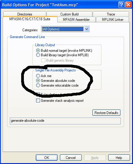

There only 26 that I found post your whole code and I'm sure mike will get you going
You are building it as relocatable code, go into Project->Build Options->Project and select the tab as attached.
To me that looks like it doens't like the path to the files, try moving them to D:\Code or similar
Thats my best guess, might be wrong
I switched to absolute, still failing:
