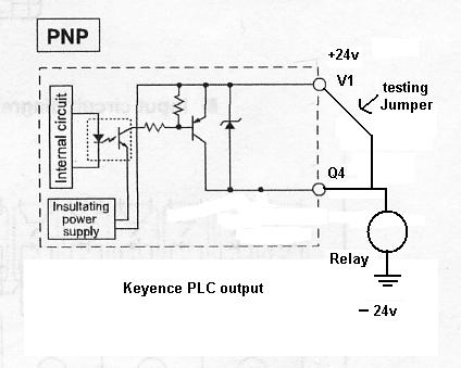

The title of the thread is somewhat inaccurate as I am troubleshooting the devices connected to the a PLC with transistor outputs and would like to know what would happen if I connect a +24VDC to the output terminals while the PLC is powered up and wired to devices.
The PLC is powered with 24VDC and the loads are connected just like in the attache pdf, so let's say I wanted to test the device connected to Q4 by connecting a 24DC to Q4 directly to see if the device will turn on. Would that damage the transistors in the PLC?

You cannot connect power directly to an output, it usually consists of a output transistor , IOW, only a suitable load should be connected directly to an output.
They appear to be sourcing outputs.

I already did :eek: and smoke came out and the outputs are pretty much fried. I was asking after the fact to understand what technically happened.
I would like to simulate it again but with components rather that a PLC, is it pretty much like an optocoupler?
Kal
The output transistor/device is opto isolated driven usually, and what you did probably was to apply full power to a device already turned on and shorted the device.

V1 connected to an output directly, shorts the output device.

Thanks Max. I had to think about this a little and I don't get why connecting V1 to let's say Q4 in the above attached diagram would short the device connected to it (Marked L in the diagram). I thought it would short out the PLC output itself not the device as the function of the output is to source 24VDC from V1 to the outputs when they are turned on.

L= load, relay coil etc, Imagine a transistor used as a switch for a relay coil connected to its collector, now instead of a load, you place the supply directly to the collector, now when the transistor turns on, it is a short circuit which over loads and destroys the output device. in this case the output transistor.

I don't see how jumping the Plus to the output Q4 could have done any damage to the PLC>
You must have done something else like putting a ground on Q4

I just thought of something else. Your PLC mite have a 3 state output On Open Off
If so If you put the +24v on Q4 when it was in the off state It would Smoke.
The output in the Keyence is Just on Open as in the diagram I attached.
Looked up yours and its just On or Open
this is from your manual
Discrete output logic Positive logic (source)
The way I interpreted it the Kal_B placed V1- on the output which is a sourced output apparently, and this would have shorted the output transistor, as I already posted..
