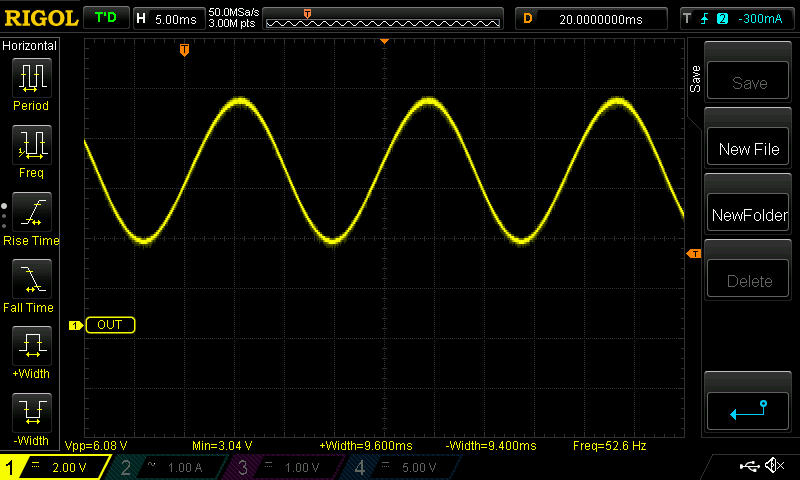

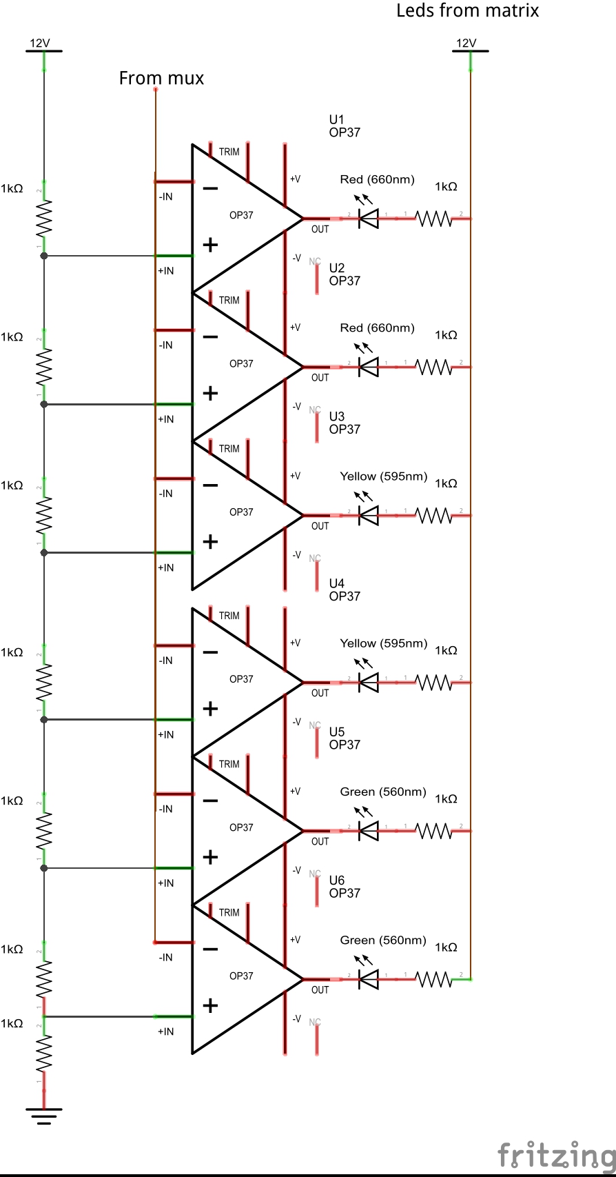

now then, another problem, not with filters but vu section: this is the output from bandpass filter i made, but the next thing i can't figure out is how do i feed signal correclty to my circuits vu-section? it's made of comparators, lm393, wich are connected to single supply. if i hook it like this, some of leds are never off, and that looks quite dumb when no music is going and still it shows bars....and then if i feed signal via bypass capacitor, then it fixes that problem, but then signal is AC and well according to datasheet, lm393 won't like ac fed in input pins. Should i ask this in another/new thread?
hmm, unless i change that resistor ladder so there is positive offset? should do the trick
yup, that did the trick, thanks for help again!
Why are you trying to make your own LM3915 LED dot/bar driver IC that has 10 comparators, an input that accepts an AC signal averaging at 0V, a built in adjustable voltage reference, simple adjustable brightness, outputs with current regulation and works from a single supply voltage? Each of its steps is 3dB, yours is linear.

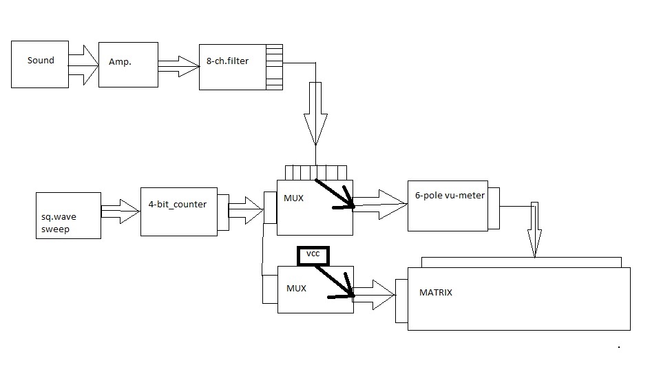

and it's not only vu-meter, idea is that there are 6-8 frequency bands that are checked/sweepd one after another and then each drawn in their own (multiplexed) columns. Here's raw block diagram, there is small difference, linear-log converter right after input amp, basic opamp-diode-thingy. And, i know there is ready-made chip (eq-something? around 3-5$) that does all this, excpect that led-matrix in dil-8 packacke. only thing that needs doing now is that filter section, been doing that currently so hpf (2nd order, 2x1st order HPF->buffer->LPF 2x2st order) But, i gladly hear any stuff you have in your mind that might be useful!
You are making what is called an Audio Spectrum Analyser Circuit. There are many of its circuits in Google Images. Some of them work and others don't.
Many circuits use a Multiple Feedback Bandpass Filter for each frequency band.
Are you familiar with microcontrollers?
With an 8bit mcu ( Pic, Avr, ... ) running FFT you can make at least 30 band single chip real time spectrum analyzer.
+ some driver electronics for the Led matrix.
yeah, buddy made recenty OLED-based spectrum, and i'm somewhat familiar with arduino, suppose that counts
A Sallen Key filter makes a good highpass or lowpass but when you add a highpass and a lowpass together they make a poor bandpass. Look in Google to see how a Multiple Feedback Bandpass filter makes a pretty good bandpass filter but it is narrow.

There is FFT library for Arduino.
thanks, i'll look and give that more thought, looks handy, and takes a lot less space than this ''bomb''
If you have 5 rows of LEDs where each row is a bandpass frequency, and the rows are multiplexed, then each row is turned on 20% of the time and is turned off 80% of the time so the LEDs will appear to have only 20% of the actual current that they have. You need to increase their current 5 times for them to appear as bright as if they were turned on continuously.
