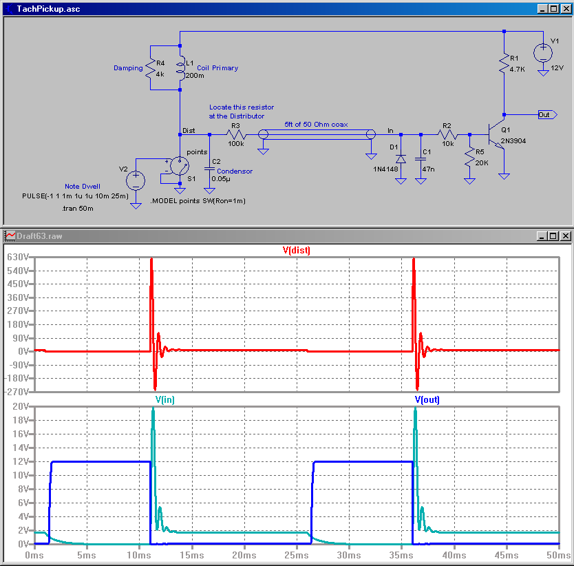

Hello,
I am attempting to design a circuit to produce a 5V logic 5.0ms pulse when an input lead goes from +12v to floating (think motorcycle points ignition). Continuing with the automotive theme this circuit will have to operate over a voltage range of 10-14v and heat range of 10F - 150F.
I took a few circuits classes around 20 years ago so I know just enough to be dangerous but am willing and excited to learn/relearn things.
My current thinking is a power regulator circuit to create a stable 5v environment then some sort of monostable multivibrator?
I have been poking around and found CD4047BE which is an RLC based multivibrator but I am not sure if this is reliable/accurate enough or if I would need something that uses a crystal? (are these more accurate?)
Lastly I could use some help with how to deal with a +12V -> floating trigger line. I would guess a pull down resistor? But what to do about the line when its +12v?
Thanks for any help!
-G

I have measured the voltage across the points with an oscilloscope. I saw voltage excursions as high as +-200V as the points open. To use this signal for a tach pick-up, you have to do some serious clamping/filtering. The sensing circuit also has to maintain a high-input impedance not to effect the spark.

Here is sim of the situation. I created a crude model of the coil/distributor. I adjusted the coil inductance, resistance, and the damping resistor to create a signal similar to what I remember observing on the o'scope.
I use a 100K resistor at the distributor connected to the rest of the circuit through ~5ft of shielded cable. This does two things, first it prevents radiating the ugly points signal into other wiring (or your radio), and the capacitance of the cable acts as a low-pass filter.
The rest of the circuit filters/clamps the voltage to switch the NPN transistor. The duty cycle of the transistor output reflects the dwell of the points...

I'm not that familiar with the charging system on motorbikes, but I would be inclined to regulate the nominal 12V battery voltage to about 9V. 5V is a little low for 555 circuits; they seem to behave better at ~9 to 12V. The circuit I posted above is for a standard points/capacitor ignition system. It could be used to trigger a 555. You could use a much simpler circuit to interface the 5V pulse you showed to a trigger a 555 powered off 9V.
