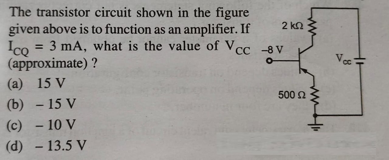

Can you please solve the problem attached.It is very confusing to me

The circuit is not "tricky".
Why is it confusing to you?
It should not be if you understand how BJTs work.
I say that the circuit is "tricky", as in, there are several things which don't make sense.
The transistor is drawn as a PNP type.
A PNP transistor has the emitter connected to the +ve side of the supply and the collector to the -ve side.
The "supply" is drawn as a battery (a single cell actually), the long stroke of the battery symbol is usually the +ve side.
But here we have the +ve side connected to the collector and the -ve side connected to the emitter.
This is the wrong way around for the PNP transistor.
We are told that Icq is 3mA, I assume this means the quiescent collector current is 3mA.
I assume that the transistor has high gain so the base current is very small compared with the collector current, so we can say that the emitter current = collector current = 3mA.

I don't see anything fundamentally wrong with the circuit, except that the Vcc voltage source is shown with a polarity indication. The student needs to decide whether Vcc will be positive or negative.
I'd interpret it as the forced -8V on the base causing the emitter to be at somewhere around -7.3 to -7.7V, depending on the transistor type. Call it -7.5V
The transistor will be fully saturated with something around 15mA base current and the only 3mA collector current, so the collector will be at virtually the same voltage as the emitter.
With 3mA through a 2K collector load resistor there will be 6V across that resistor.
-7.5V to the emitter then another -6V collector to power = -13.5V supply voltage.

This question is tricky. The reasons follow.
The design overdrives the base more than the collector, but this part is irrelevant. Even if it is a poor design, you must still answer the question.
The battery symbol, Vcc is shown backwards for a PNP, so it must be negative.
You may assume -0.1V drop for Vce or Vec=0.1 , although at this low current, Vec = 0 is closer to the truth. (20mV) as a very low current saturated switch.
The base current is irrelevant, but emitter voltage determines the KVL drop to Vcc.
You need to know that Icq is always determined by Vbe in linear mode and if saturated and we neglect Vce* then Icq= (Vcc-Ve)/Rc and Ie=Ic+Ib means Ic is not controlled by Ib.
Since Icq was given +ve , we will subtract it here only , Vbe = -0.7 V.
Thus all you need Ve = Vb + Vbe = -7.3 , Vc~ Ve - 0.1 ( -ve for PNP)
V(Rc) = 3 mA * 2k = -6V Thus Vcc = -7.4 - 6V = -13.4
However if Vb=-8 then assuming 0.65V, But for approx. use 0.7 or 0.6 for single precision.
Ve=-7.3 as the emitter is more +ve with P-N junction for emitter-base.
Then from Ohm's Law V/R=I= -7.3 / 500 Ohms 14.6 mA approx. for base current is much more than Icq.
Yes weird, unconventional, tricky, poor design, but still answerable.
