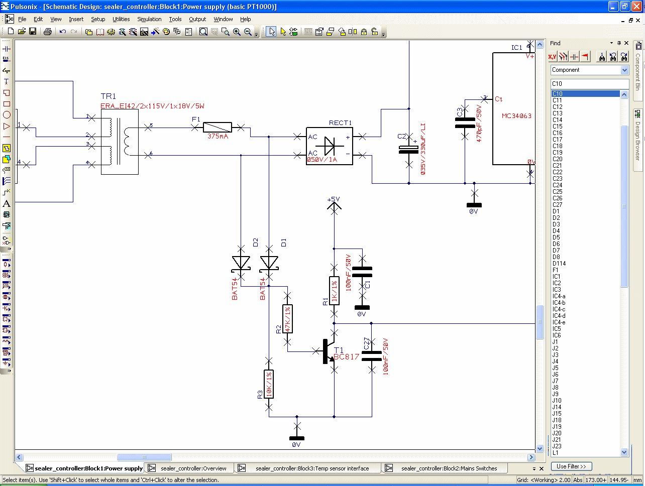

Ok, it was indeed the zero crossing detection which failed.
I attached a schematic. The problem is, that I get some sort of drop-outs in the resulting signal.
I added C27 today. This should have been there all along (shame on me), but it does not seem to completely solve the problem.
I set the software to supply a single phase (= one positive+ one negative) each 200ms. appr. 19 out of 20 times this works and then either a pulse is skipped, or a double pulse is provided.
I am also having troubles to get the oscilloscope to trigger on the mains current measurement.
I ordered for a current sense transformer so I can trigger on the zero crossing signal and view the mains current at the same time.
Hopefully I will be able to find out more soon.

I think the problem might be caused by phase shift in the transformer aupplying the circuit and the current not being zero when the voltage is zero due to the fact that the trasformer is inductive.
I don't think so. I also tried the controller on a purely resistive heater. The same effect is seen here.
Also I found that with the load attached the transformer actually behaves a lot like a normal resistive load. I even do not see the rather large 6A startup peak when the load is attached. In that case the current amplitude is 3A in all cases.

After I got my problems with the zero crossing fixed, I was rather satisfied with switching the transformer. Not funny spikes anymore.
I would recommend against the triac after the transformer, because all TRIACS have an appr. 1,5V voltage drop.
1,5V at 1A (before transformer) = 1,5W
1,5V at 16A (after transformer) = 24W = very hot Triac + relatively high losses.
In that case I would recommend rectifying and using a FET instead.
Or you could use the TRIAC to do the actual heating ;-)
