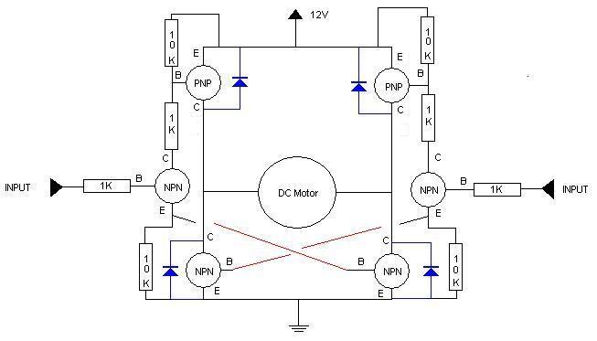

Im thinking of using this Hbridge cct. Actually this belongs to PIKE. And i hope you dont letting me make of it as a reference.
As Nigel mentioned previously, a resistor is required in between the PNP base-emitter junction. Any value would do right? Just as long as it keeps the transistor OFF.
As shown below in this diagram, there are 2 10K resistors connected at the NPN emitters, why are they required ?
1. Lower value base-emitter resistors (Rbe) will allow the PNPs to turn off a little sooner, at the expense of requiring more current from the driving transistors. The current through those resistors when the PNPs are on is Vbe/Rbe. Even with 1k, that current is less than a milliamp. Since you are driving about 10ma into the base nodes, that is pretty insignificant. On the other hand, since you have to build in generous dead time at switching time, turn-off speed is probably not critical. For the circuit you have drawn, my personal choice would be 1k base-emitter resistors.
2. Notice that the resistors at the NPN emitters also connect from base to emitter of the lower H-bridge transistors. Without the resistors, those bases would be floating when they are off, just like the PNPs.
10K would be fine!, it's not at all critical.
They perform the same as the top 10K's, as Ron H says.
