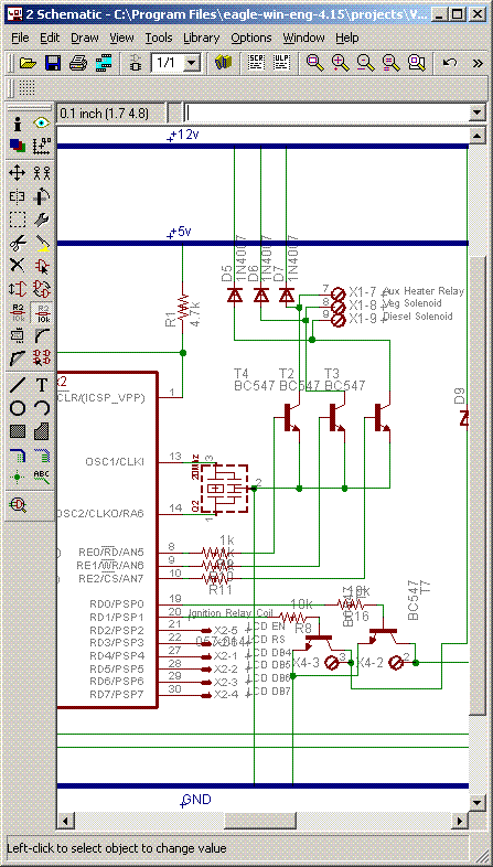

I'm using transistors to switch external loads for my PIC project. I'm using NPN transistors (specifically these: **broken link removed**) with the PIC's output pins connected to the base of the transistors. I have a base resistor of 10k, which I know is too high but that's not my problem. The load it is switching is NOT 5v - it's about 14-15v (automotive relays eventually, but still on the bench right now.) It's actually switching the GROUND for the device, not the power. So the emitter is tied to the ground plane and the collector goes to the screw terminal to be connected to the device's ground wire.
When I test it using the regulated 5v on-board, the transistors completely turn on/saturate to 5.00v, and turn off to 0.00 volts. But if I use my volt meter on the ~14v supply voltage, it turns on/saturates fully to about 14.8 volts, but it only "turns off" to about 6.38 volts. Why is it still letting through 6 volts with a 14/15v load but totally turning off for a 5v load? The PIC pin is low at 0.00v measured - so the transistor base is getting no voltage or current. It seems to be "leaking" through the transistor despite being turned "off." Any ideas?

I think it's time for you to post a schematic showing exactly how you wired the circuit, including the 0V for the two supplies connected together.
Double-check the pins on the transistor. It sounds like you swapped emitter and collector resulting in a zener diode when it is off.
Here is part of the schematic that shows 3 of the transistor/diode pairs. Please note the eagle part # for the transistors are not correct, I just used them because they had the right package and electrical schematic and didn't feel like reinventing the wheel just so the label would be right

Hey guys, I didn't get a chance to do much with it last night as real life interrupted The coil load measures 96-100 ohms. The grounds of both circuits are connected, and the transistor does seem to get a LITTLE warm, but certainly not hot.
Emitter and collectors reversed - entirely possible. ARGH! Just checked the datasheet for the transistor and the E and C are backwards of what I thought they are. That explains it! That should fix my problem, at least until I move to driver arrays

Backwards transistors make a pretty good zener diode when the emitter-base junction has avalanche breakdown at about 6V or 7V. Then it is in series with a forward-biased base-collector junction.
Some transistors actually have a little current gain when backwards. :lol:
