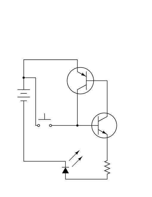

I've got a working circuit, see bjt_latch.jpg I think I have a decent understanding of this, but maybe not in light of what I constructed myself and didn't just find on the Internet. I also noticed that I can turn this bad boy on with just my body capacitance. :) I presume this is due to a positive feedback loop between the two transistors? It's sorely lacking of any ESD protection, however.

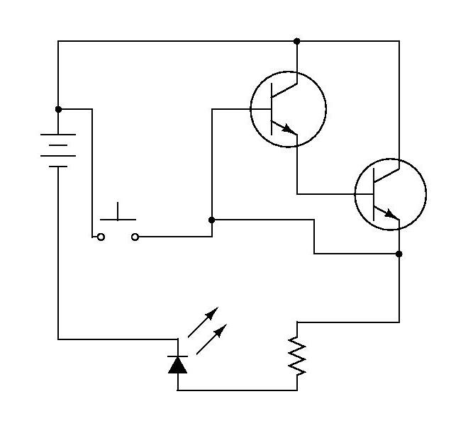

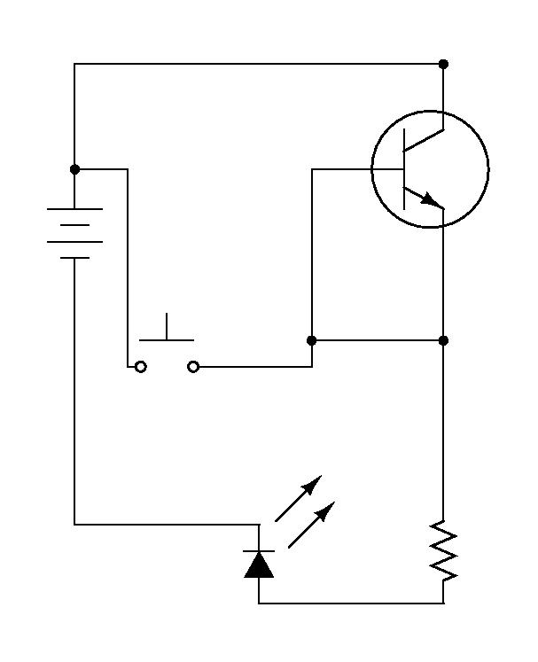

I first designed this bjt_latch_no_workie.jpgwith a looped-back NPN transistor. I'm posting because I was hoping someone here would be so kind as to tell me why this circuit does not latch. I'm driving it at 5 volts, everything is pretty standard small signal components. I also tried this npn_no_workie.jpg circuit which is a darlington pair with the emitter looped back to the base.

In the second circuit, the transistor seemed not doing any job, even if you removed it, lamp will be off until you press the push button, it will be ON.
The same thing in the third circuit.
Your circuit won't latch because by tying the base and emitter together, they're at the same potential, hence turning off the transistor. For the transistor to conduct, you need a Vbe potential difference of about 0.7V to bias the base-emitter junction - does the transistor actually switch at all in your circuit? If you want a simple latching circuit with a single component, try a thyristor...
I've got a working circuit, see View attachment 43084 I think I have a decent understanding of this, but maybe not in light of what I constructed myself and didn't just find on the Internet. I also noticed that I can turn this bad boy on with just my body capacitance. :) I presume this is due to a positive feedback loop between the two transistors? It's sorely lacking of any ESD protection, however.
add a base resistor, a base emitter resistor and a base emitter capacitor to the lower transistor to shunt the static around the base emitter junction
