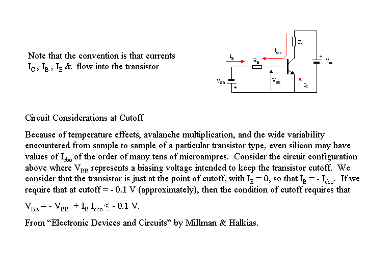

Yes, now I understand. It should work without R3 I suppose, but it's better to include it for safety. anyway.. why does R3 prevent the transistor turning on due to the Icbo and If currents??
R3 pulls the base positive, turning the PNP transistor off. If it's not there, any slight leakage towards ground will tend to bias the transistor on - by providing a larger 'leakage' through R3 to the positive rail it overcomes that possibility.

I expect it would work at room temperature without R3, but it would fail at higher temperatures.
What you need to understand is that a transistor is a voltage controlled current source, ie. the collector current depends on the base - emitter voltage. It is an expontial function and it varies with temperature.
Icbo approximately doubles for every 10 degree C rise in temperature for both silicon and germanium transistors.
Len
Attached is a quote that answers this question
Len
