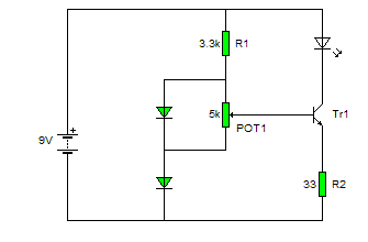

Try this.

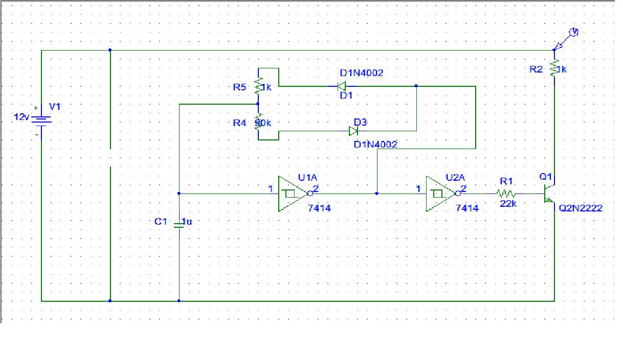

hmm... is this good enough?

hmm... pwm controller or simple transistor based driver????
Ok but if you need a real pwm crkt you need to have more components!
6 shmitt trgrs have a foot print of what 14 ????????
That will work, you can also buy tiny SMT ICs with only two Schmitt triggers.

My only concern was that it might not turn off fully.
This circuit should fix that.

current varies as pot changes.but it does not change voltage drop on LED.I assume as pot changes voltage drop on LEDs should change becase as pot change Vb changes therefore Ve should change making voltage drop on LEDs to vary
Simulators tell lies.
The voltage across the LED should vary, but not by much.
The current through the LED should vary and the intensity will vary.
I suggest you build the circuit in real life rather than blindly trusting a simulator.

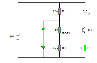

is it has to be 5k pot?
can i use 30k or 100k (i have 30 and 100k with spindles thats why)

You can use a 30k pot (I've never seen such a beast) but you need to increase R3 to 22k if you want to use it.
I wouldn't suggest a higher value, I'd recommend going lower, do you have a 2k or 1k resistor?
You can use 30k if you like but it's bit high because of the loading created by the base current.
The regulator works because the base-emitter voltage is roughly equal to 0.7V and the diodes drop 0.7V each (1.4V in total).
The base voltage of Tr1 is varied between just under 0.59V to 1.4V as the pot is adjusted, the emitter voltage will always be 0.7V below the base so will vary between 0V and 0.7V.
Because the voltage across R2 is kept constant Ohm's law that the current through it remains constant so the current will vary between 0/33 and 0.7/33 or 0 to 21mA.
