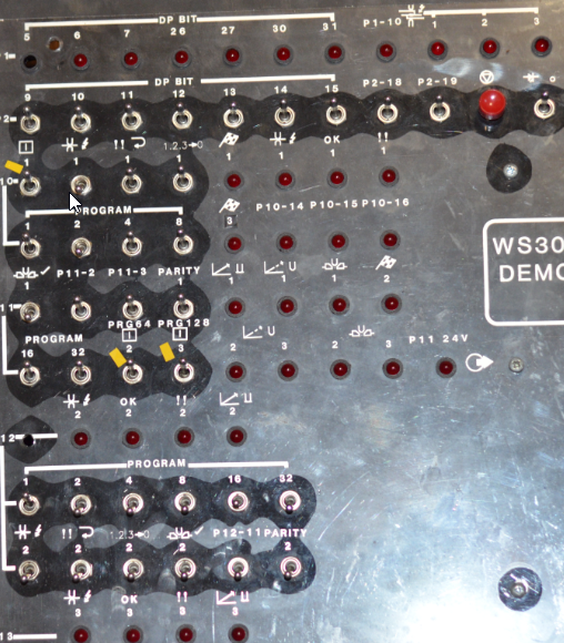

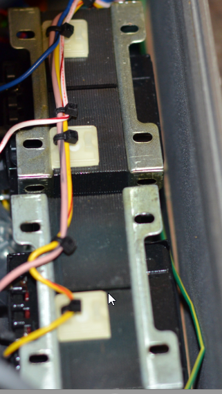

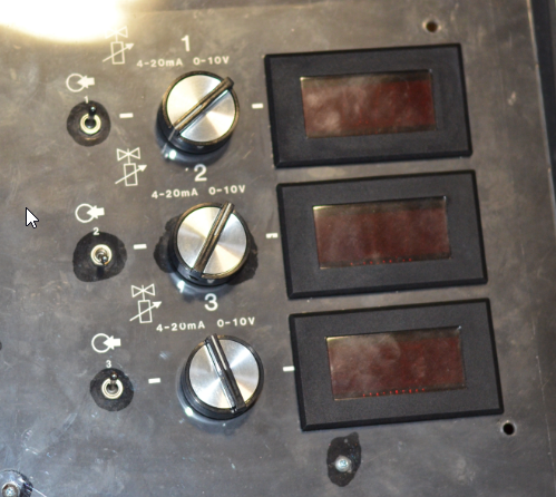

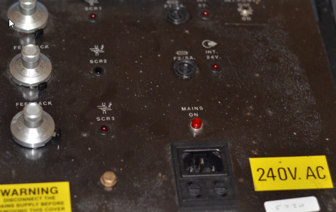

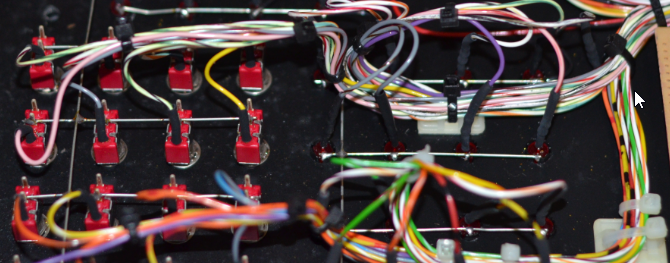

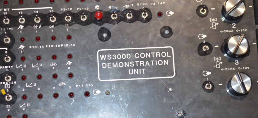

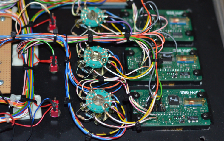

Ok back on topic! I have some Pictures, They are not very good, especially the transformer picture, because i have not got the thing dismantled properly yet. Also it isnt as neat as it was, I had to pull it around alot. One other thing, I am having real trouble getting the dial thing off the pot! I think there is a kind of hex screw holding it to the pot shaft, I have tried loads of allen keys, both metric and imperial, all very small but non seem to fit. I cant get a good look at the screw (if it is a screw) so i don't know for sure that it is a hex screw. Anyone know about these things?
Enjoy the pictures! Oh and before anyone point's it out!! DOH DOH, yes i can see where it say's DEMONSTRATION UNIT!
I just forgot it was on there, and it has been packed for a fairly long time.

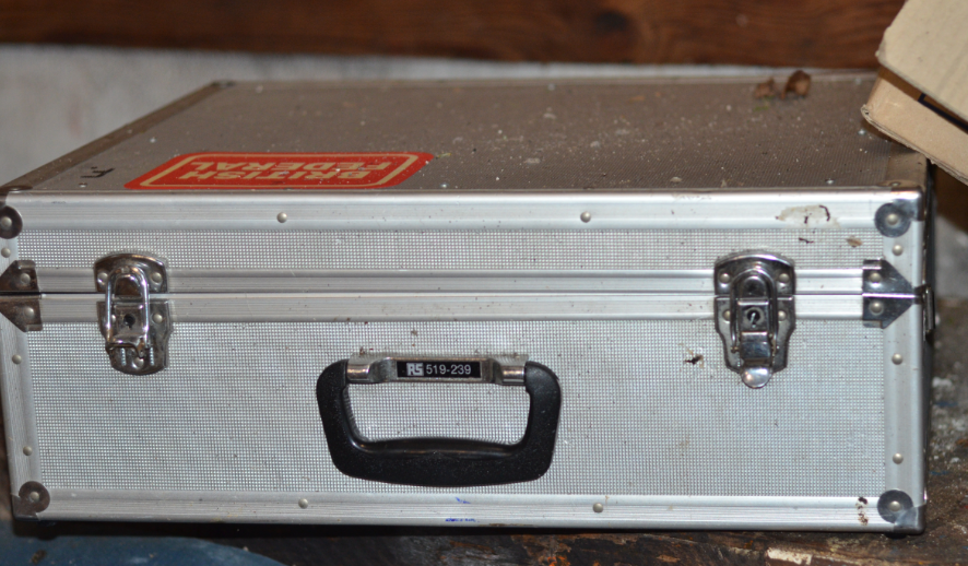

Couldn't find anything contributory for the WS3000. Did find the nice aluminum case at RS: **broken link removed**
The knobs are probably Allen /hex set screws or small slotted screws. Try a jeweler's screwdriver.

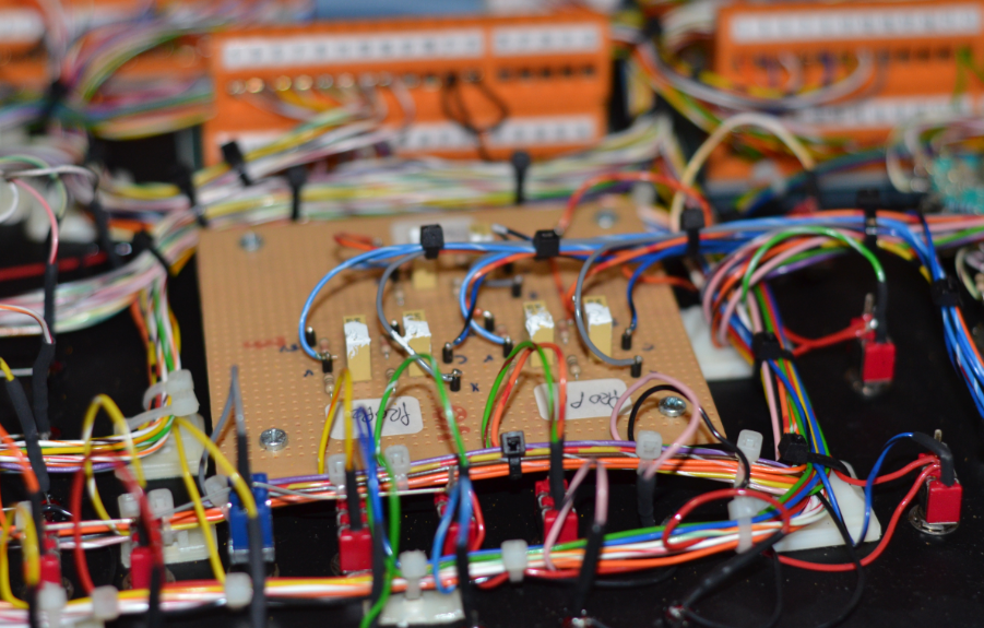

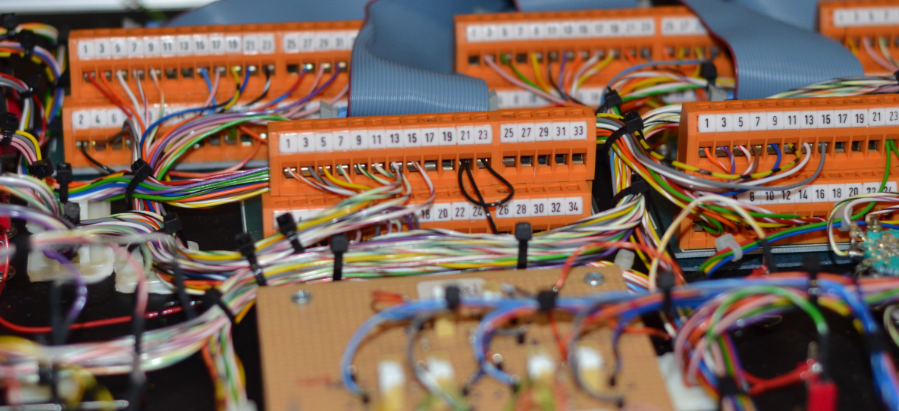

It is a shame I messed it up a little getting the top off. It was far tidier inside, everything looks hand soldered with alot of attention to detail. Part of me want's to keep it as it is, And part of me would like some of the part's! lol, especially those ten turn pots! and the dials for them! I will try and get the transformers out tomorrow, There appears to be 4 transformer's although two are pretty small. Two look very useful! Also i like all those connectors, i don't have many of that type, and they are expensive (for a kid at least).

It should be a vary small set screw. Probably a hex but some came with torx heads.
You may not find the right size in a standard key set.
Most of the time those knobs were shipped with a tool when you bought them.

If you have a two way radio repair shop around they may have one that will fit. I used to carry a coin bag full of them. They are vary small.

Thanks' that helps alot. Maybe i could grind a normal allen key with the Dremel!
Most of the turns-counting dials use 0.050 hex. Bristol looks really wierd, but they have been used for knobs too.

Before I saw the pics I would've said that some welders have a second 'transformer' in series with the output of the main transformer (possibly after the rectifier) which is actually just a big inductor to help sustain the arc.
Having seen the pics, I'd have to say it doesn't look like any kind of welder I'd recognise, and those transformers look too small for welding and are probably just providing power for the electronics.
And yes you can series connect transformers / windings depending on what you're trying to do.
I have maintained british federal industrial spotters, they are nice machines.
That as you say looks like a demo unit to demo the timers rather than the welders, BF did release some retrofit timers for machines that were older and used thyratrons which were filled with mercury.
You can series and parallel transformers so long as you keep start and finish connections correct, for series start of one winding goes to the finish of the next, parallel start to start and finish to finish.
Seriesing primarys isnt reccomended unless the trannys are exactly the same, ie designed to be used in pairs, if an inbalance occurs due to diffo's in windings one of them will burn out.

Edit: I meant Ignatron not thyratron, the latter is even older.
